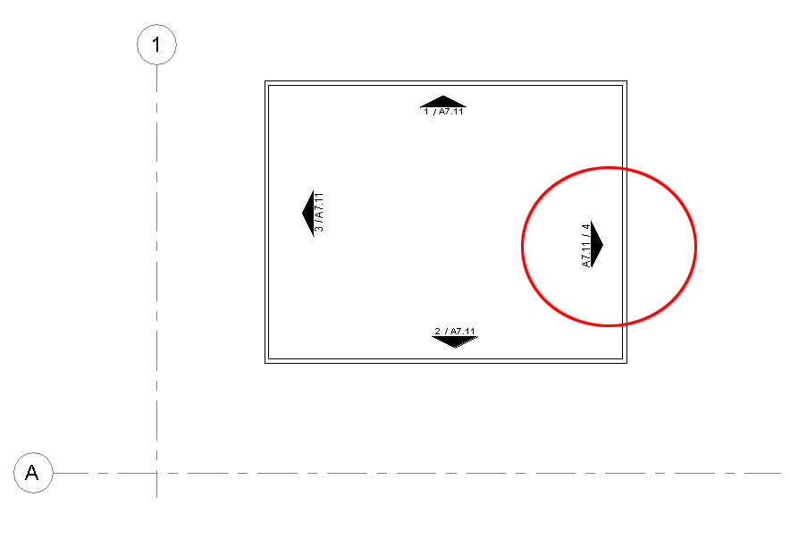

I have an elevation tag that when I bring it in it mirrors the detail and page number text.  I poked around in the family a bit but I have no idea why this is doing that.  Does anyone have any suggestions on how to fix this?  I have attached a photo of what Im talking about
Thanks for your help

Hard to say without seeing the family
Wed, Apr 23, 2014 at 1:11:55 PM | Elevation Tag Hell
I think this is easy.  This tag has three parts.  "View - / - sheet"   Because of the always readable rule, the text is rotated in-place to be readable.
Wed, Apr 23, 2014 at 1:23:55 PM | Elevation Tag Hell
emanno
Joined: Mon, Nov 11, 2013
0 Posts
WWHUB
Thanks for the info I didn't even think to look at that.  I tried un-checking the "keep readable" option inside the famil but it didn't work.  Is there something else I can do that Im not noticing?
Im going to play arouind with it some more.
Thanks again!

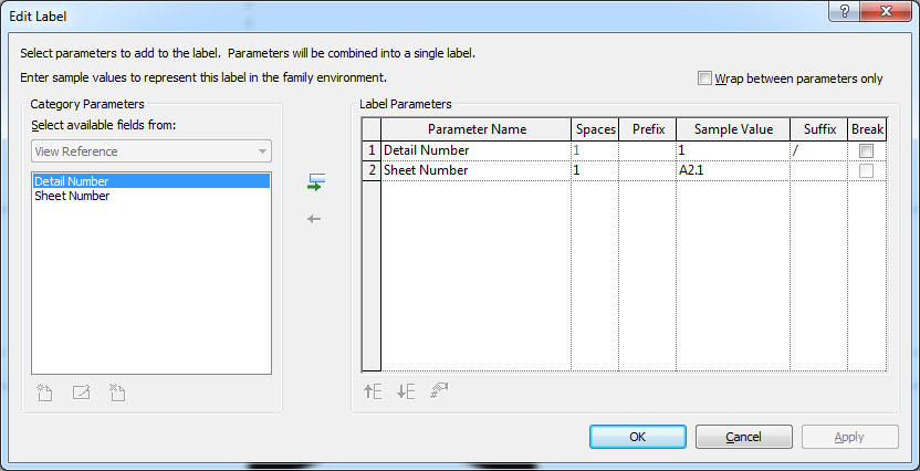

Wed, Jun 11, 2014 at 9:43:49 AM | Elevation Tag Hell
blue442
blue442 Avatar
Joined: Tue, Aug 25, 2009
0 Posts
5 Stars: 1 Votes
to solve this, i put all the requirements of the tag in one label.
see attached image.
