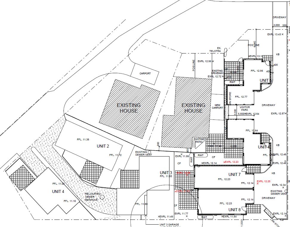

i have a project with 6 new buildings 2 of them (unit 2 & 4) are on a angel and i need to rotate them
so there square on the drawing sheet. i know you can rotate them 90 degrees but i can't figure out how to rotate it
any outher angle.

The rotation on the sheet can only be 90 degrees. You can however rotate the crop region in your view and it will rotate your building.
