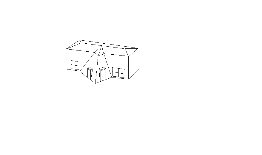

Hi I am a student who has just started working with revit 8 and I am trying to Put in a wall that is angled angled. How do you do this?Not a very good drawing but i want to look something like the front of this.

If you go to your tools palette (Basics, View, Modelling, etc) right click on it you'll notice there are massing tools. Create a mass of the volume you want and then use the Wall By Face tool to create walls out of your mass volume.
Tue, Feb 28, 2006 at 4:23:41 AM | RE: Making Angled or canted walls
eldados
eldados Avatar
Joined: Mon, Mar 14, 2005
777 Posts
4.5 Stars: 8 Votes
like arccodex said, a mass is the best option, though you could also do it an an in place wall family using blend... what ever easier Smile

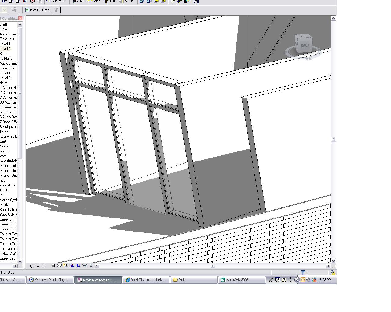

how do you cut out the middle part of this condition, I have put it in as a glass wall, just like what is said above (massing) but now i can figure out how to cut out for the door!   The storefront is canted out.  any help? some step by step directions would be greatly appreciated.  maybe with from the beginning to make sure i have constructed it right.  currently the mullions follow the cant, is that a new family i have to make so they are flush with floor and wall?  please help!  thanks
