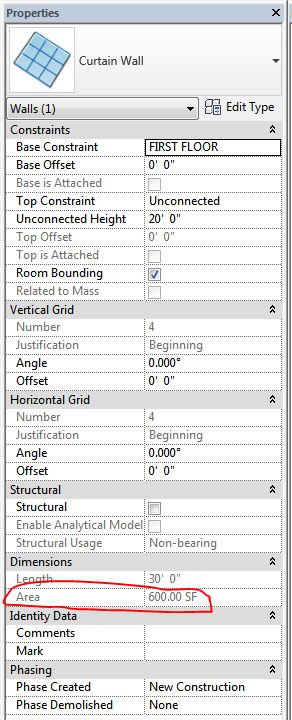

Since the curtain system doesn't have a area parameter embedded which makes harder the make the calculation. Is there any workaround for that?
Wed, Apr 16, 2014 at 7:28:12 AM | How can I calculate the area of a curtain system
Curtain walls are walls.  The area is there for the overall.
You can also take off curtain panels as a material and they have areas.
Curtain mullions can be scheduled by type and length.

I get an area when I draw a curtain wall, see attached image

Curtain system and curtain walls are not the same thing. I want to get the whole area of the curtain system inclusive mullion and panels
Wed, Apr 16, 2014 at 9:16:51 AM | How can I calculate the area of a curtain system
What?   Curtain walls are the whole curtain system!
Wed, Apr 16, 2014 at 9:27:24 AM | How can I calculate the area of a curtain system
If you had meant curtain systems created by model by face, you should have said so.  These panels can still be taken off by material and you can total the area and that will be correct if your panels go to the center of the mullions.
