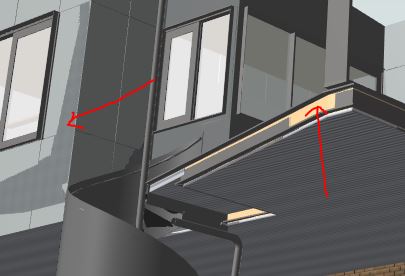

As you can see from the attached image, the timber floor behind the steel beam should't be shown while the wall cladding material (curtain wall) should have block the wall behind (shown in dark grey). Whenever I move my view around, the graphic errors will occur in different areas.
I am aware that my graphic card AMD Radeon HD 6450 might not be compatible with Revit 2014. Is this a common issue? How can I fix it without having to change my graphic card.

Turn off hardware acceleration under the revit R / options.
Make sure you have the latest video driver installed.
