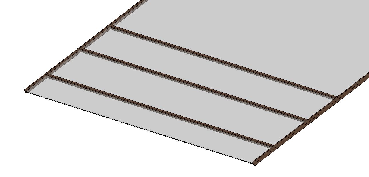

does anyone know how to extend the glazing past the mulions,...
i am using sloped glazing for a glass canopy and would like to show the glass extending over a metal gutter, but the mullions held back

Draw your sloped glazing so that it covers the gutter and just don't place a grid or mullion on the end.  If there is already a mullion on the end just click on them and delete them (may need to unpin them) .
