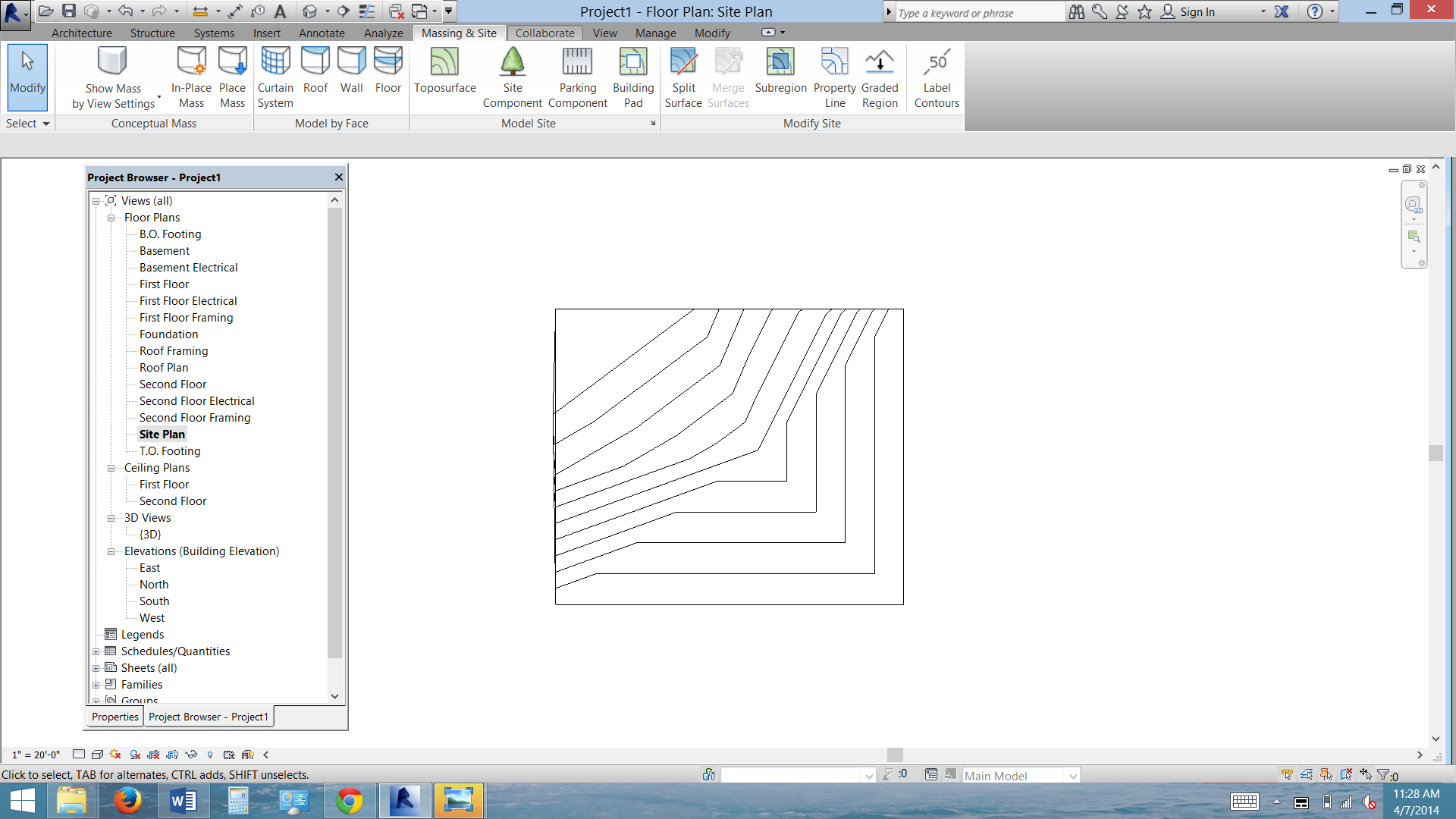

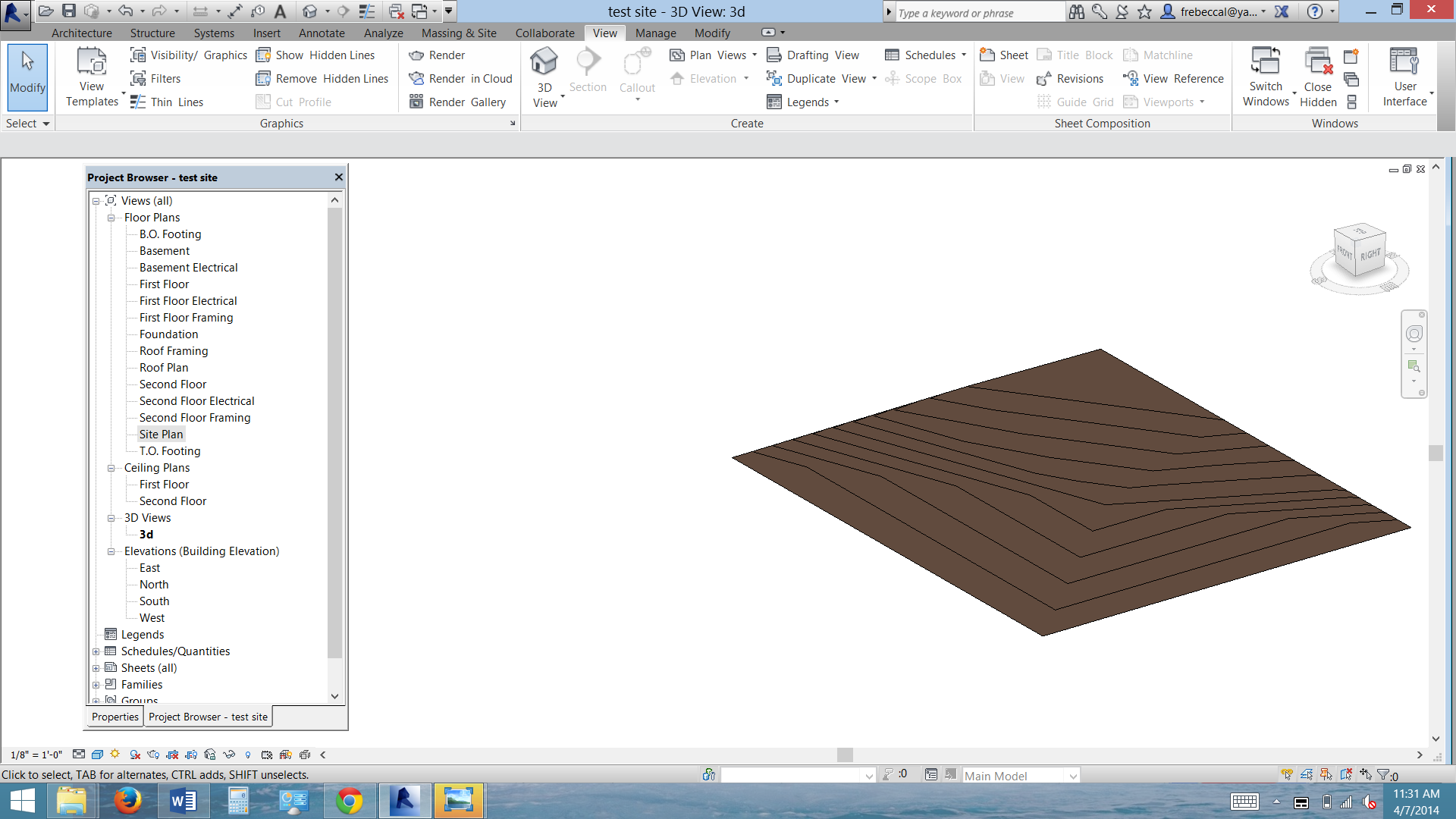

I created a property line and then added the toposurface points of various elevations in the site plan. When I go to the 3D view of the site, the topography is completely flat with only the topography lines showing up. Even when I render the view, my site appears completely flat. (see attached pictures) I am using the Student/Educational Revit 2014. How can I fix this?

Hard to say we don't have enough information from you.  Property lines don't matter.  The only thing that matters is the points elevations.  If you only have a couple inches difference between your lowest point and your highest you aren't going to see a big difference (if at all) when looking at it from far away.  You could test it by putting some points way below or above your other points to make sure you are doing it correctly.

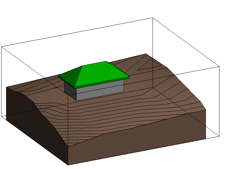

If you add a section box to the view and it cuts your topo, you will get cut "sides" to your topography with earth hatch and that will help you see the slope.

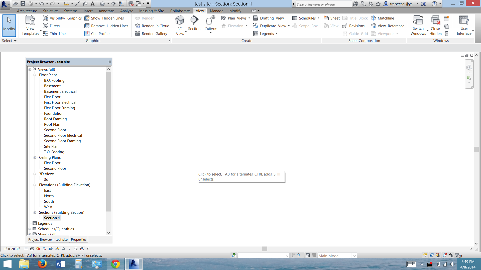

All of the units are in feet/inches. The elevation points range from 0" to 10" and the terrain appears completely flat on both the 3D view and the section view (see attached picture) .

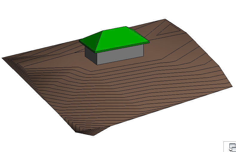

Wed, Apr 9, 2014 at 7:45:45 AM | Toposurface appears flat in 3D View
#9
This is not a problem because Revit is showing you exactly what you have.
First view - plane 3D, second view section box - left on for you to see.
