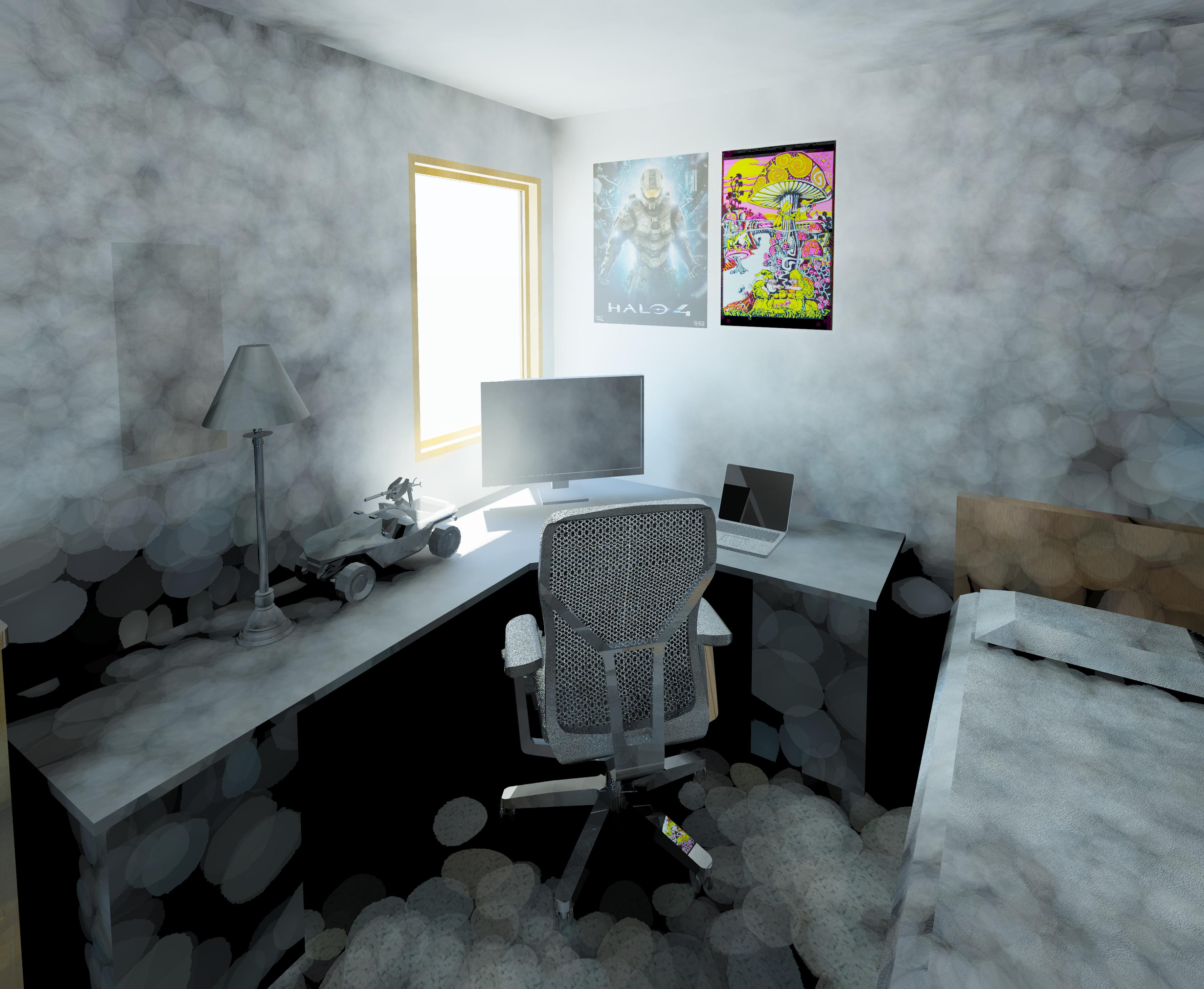

Here is a render of something I did, I hope I can learn how to get this picture 10x more clear in the future.

Im not sure where you think Revit is lacking?  Revit is leagues ahead of AutoCAD and once you learn how to use all of the powers of Revit you will never want to look back at AutoCAD.  If that was your first rendering ever its not to bad, if not you need a lot of work.  It looks like you didn't apply materials to any of your families.
Read up on Revit and go through as many tutorials as you can find.  Good Luck!

This wasn't my first rendering, I have dopped cameras into rooms and pressed the render button but this is the first project that I am starting to create the 3d objects from scatch/ download from this website. I created them in autocad and then "linked" them into revit. So i was not sure how to apply revit materials to the indiviual parts of the autocad 3d dwg. I did apply a wood material to the top of the desk but the "link" from autocad to revit was not working.

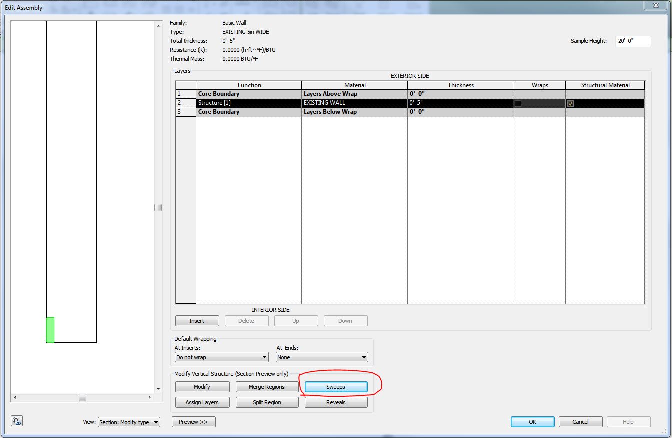

You still have a lot to learn.  You can add a sweep to a wall type that would be your top/bottom plate.  You could also actually add the top and bottom plate using a family and assign it to the correct level, if the level changes it will automatically change with it.  This could also be done as an in-place family.
