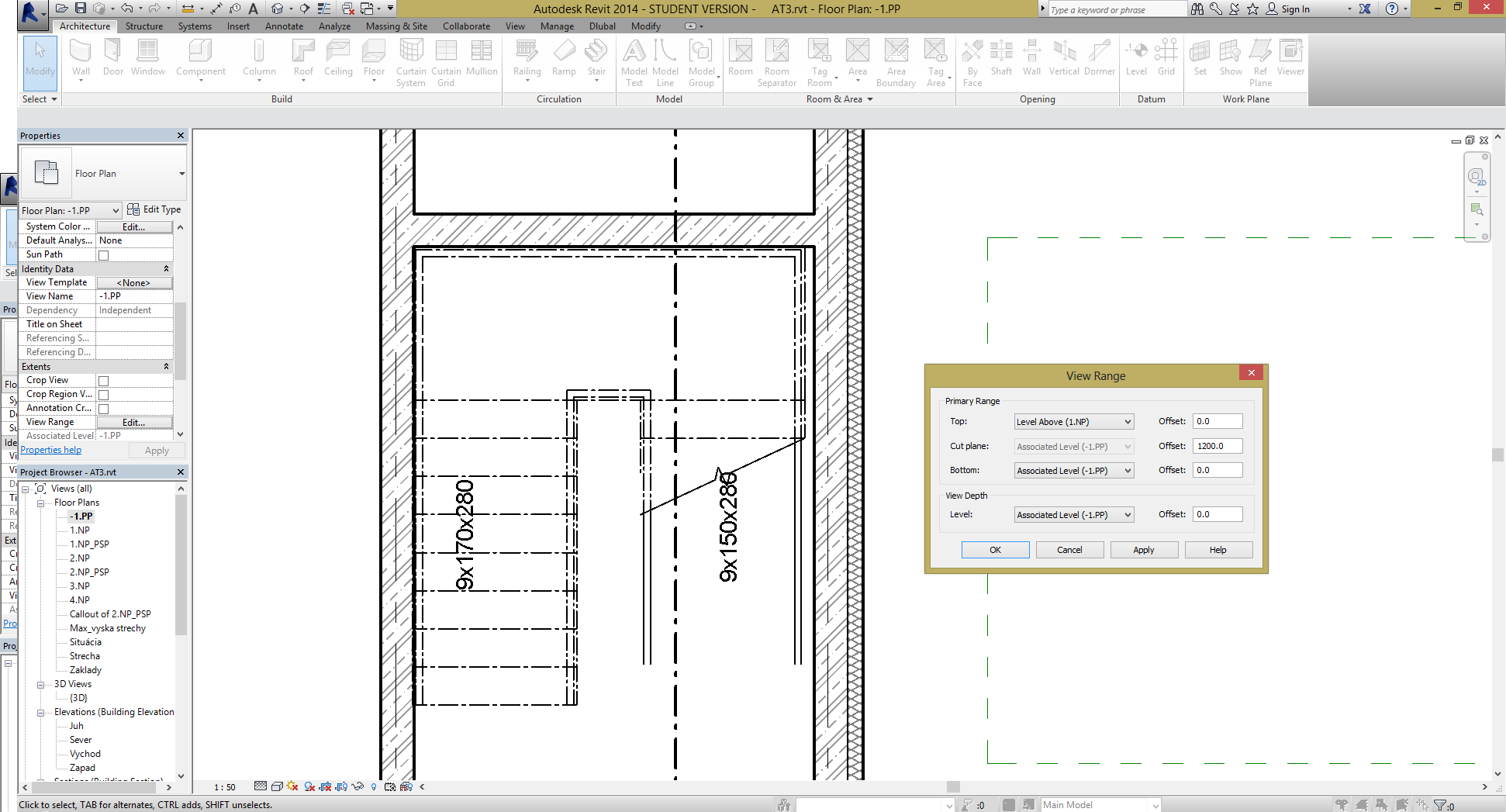

Hallo, I have a big problem stair on one floor level ist not complete.
Please help me what i must doThank you.

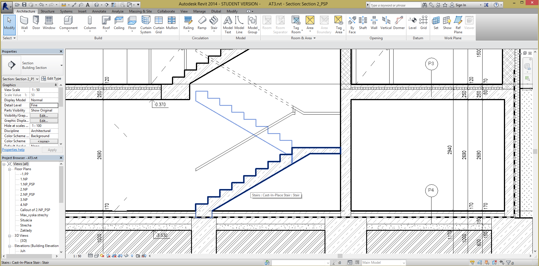

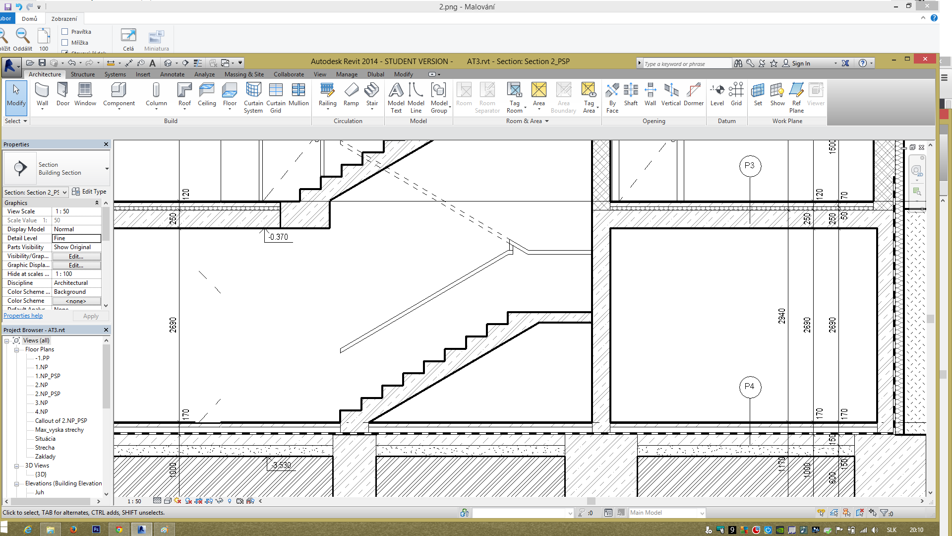

I dont see complete stair on picture 4 it is OK, but on picture 3 it is not complete :/On picture 3 on visible view graphic all on stair is ✓ , but it is not complete.

Image 3 is from a different level I assume.  Is your view range set low enough to see the stair?

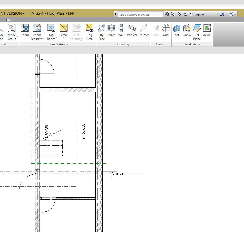

I set default view range. On all levels is the same setting.I dont see all stair :/

Set your Bottom and View Depth to Level Below and see if that helps your stair situation.  If you want to see the entire stair you may need to use a Plan Region
