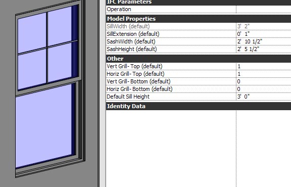

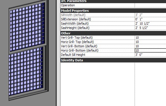

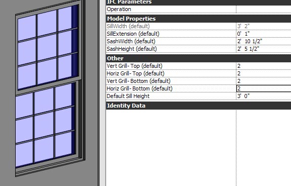

I created a way by nesting a mullion array family into my window sash.  Attached are some examples of it in action.
If there is any interest, I'll post how I did it.

Hi Kredman,
I'd be very interested to see how you created your mullion array family.  Please post!

Sure, I'll post a short tutorial and the rfa sometime soon!
