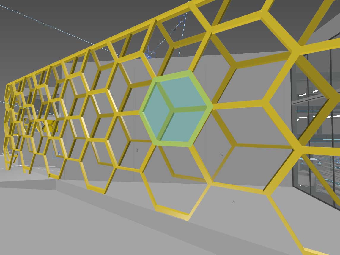

Hi all revit users,
I have a problem. I cant find a way to model facade as in the attached image (3dmax model)?.
Any ideas?.
Kind regards.
Sami.
Thu, Apr 3, 2014 at 9:29:17 AM | Double layered honeycomb facade
Joined: Tue, May 22, 2007
5921 Posts
4 Stars: 205 Votes
Use the "Conceptual Mass", here you have some examples: http://buildz.blogspot.pt/2012_05_01_archive.html
