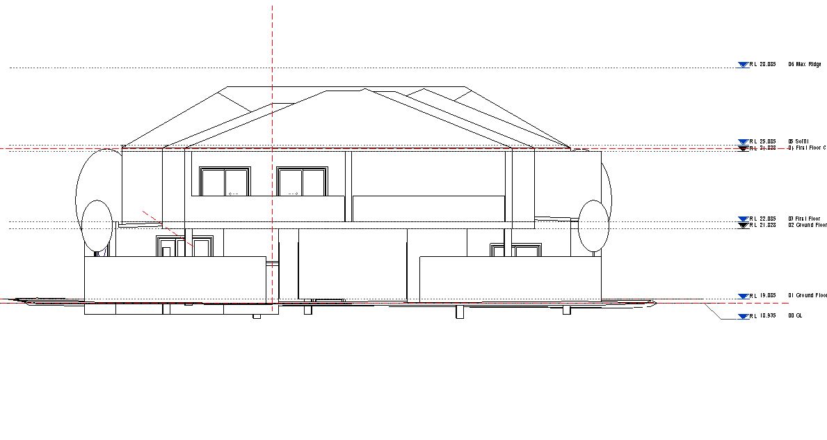

Hi Guys,

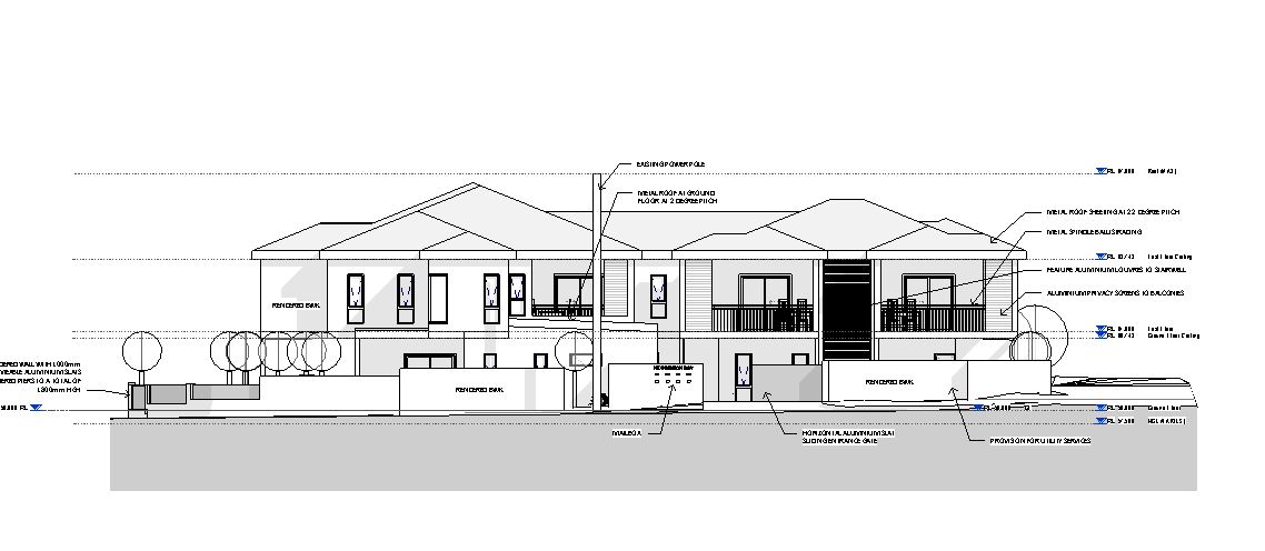

Really embarrasing but I have created a model and without remembering I managed to show the ground in the elevation as a solid hatch (see pic attached), Now I am working on a different project (pic attached) and cannot figure out how to show the ground in a similar manner... After looking at various posts on here this is so basic that it goes beyond such a simple matter :S
Any assistance would be hugely appreciated..
Tim

Make sure your elevation line cuts the topo.

And how do I check that, I know you can change the elevation depth in plan but when in the elevation, when I hit the light bulb to re-crop view there is nothing below the ground line.
Thu, Apr 3, 2014 at 6:59:49 AM | Elevation ground on/off?
Elevation cuts the gound..... In a plan view where you can see the elevation marker and the topography - make sure the elevation line is inside the topo limits.

Brilliant, didn't realise the elevation cuts were outside the topo..
Cheers mate
