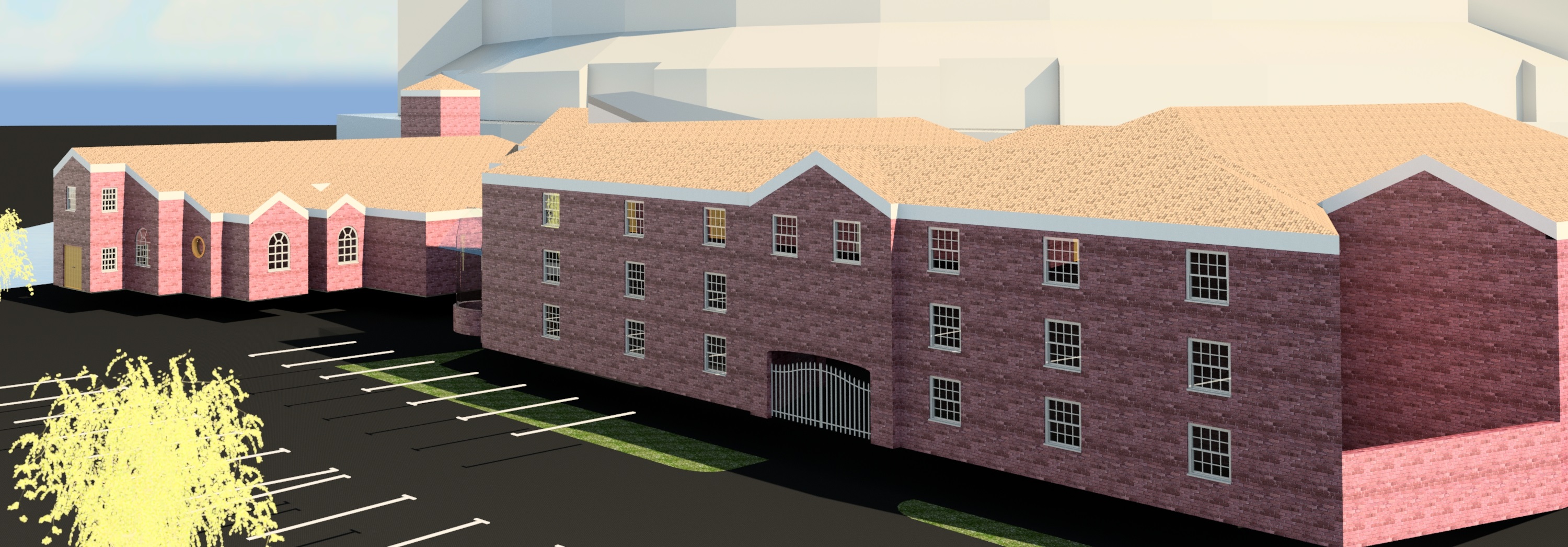

I'm having a problem where my buildings look like they are hovering over the topography, instead of sitting on it? Its a flat topo so should be alright, but as I say it hovers over a creates a shadow.I'm sure its something simple but never come accross this before. See the photo attached
Thanks for your help.

Your topography is at the wrong elevation.....Your parking stripes are where your topography should be - correct?

Correct, the topo is currently on Site level and need to be at GF level. Is the any way to change this without having to redraw the topo again?
Thanks

Just move it up in an elevation view

BTW - It really never should be at the floor level - correct?
In our climate, it should be at least 8" below the grade floor then you grade up to the entrances.  Of course this means you need to model foundation walls.
You really should be showing this in the correct relationship.....
