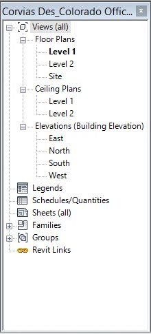

Hello- I am new to Revit, and to this forum. I am drawing a floor plan, and am trying to create a curved wall by massing in place. At this point I realized that my 3D view is missing. The wheel says 2D, and I'm not sure how to get my 3D view back. Any new drawing I open has the same problem. Eventually I woudl like to render this model for presentation, so 3D is pretty essential to this project. I'm sure this is a very simple fix, but I can't seem to figure it out.
What am I missing, and how can I fix it?
Any help is greatly appreciated!!
Thank you!!!!

Under View>3D view you can create a new 3D view

Thank you! I knew it was something simple.
