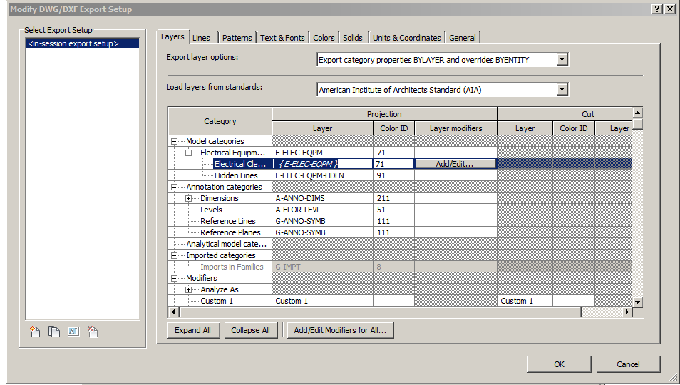

good afternoon. i'm using Revit 2014, and have an issue with clearances. the project that i'm working on, i'm modeling the Electrical as part of a coordinated effort. i have taken the items (VFD's, Panels, Light Fixtures...etc.) and added a clearance to them. i created a new subcatagory in the family for Electrical clearance, and have it working in revit. it looks right, and i can strech them up and down to the floor and ceiling. when i export the 3d view to either .dwg, or .nwc it makes the equipment, or light fixture, and the clearance into one item with only 1 layer. the BIM coordinator for the project wants to see it in .dwg with a seperate layer for the clearance, so that he can have visibility control to make the clearance semi-transparent and the item solid. i have looked, and can't figure out what is going wrong. any ideas?

Vinny - I don't do MEP but I think your problem is category..... What if you make this item a sperate nested family in a different category.  You could run a quick test by loading a simple family into yours ... doesn't have to be correct for the test.

i still don't know what i'm doing wrong. i started with a Electrical Equipment family model. i then inserted a Electrical Devices family item into it. then i loaded that into my model and exported that to .dwg. it still only has the electrical equipment layer in autocad.

Was the nested family shared?

here is the family that i'm using. please take a look at it and see what i missed. i looks and works great in Revit, but only has one layer in Autocad. can i adjust how it exports to Autocad?

Vinny
Change your cad export setup.

By George, that worked.. thank you so much. i knew it had to be a simple fix. but i was racking my brain on it.
