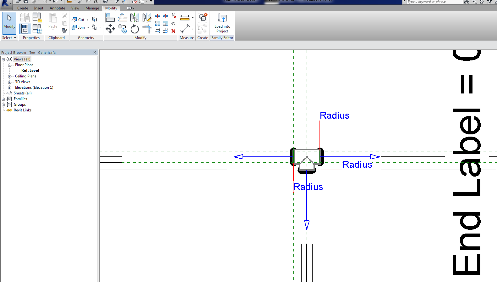

That's where I was trying to edit it. I can select a two objects neither of which are lines. When the object is selected I get the option to edit sweep. there is something called witness lines?
Thu, Mar 20, 2014 at 4:16:08 PM | How to get pipe fittings to appear as simple pipe lines?
Johnzo142
Joined: Fri, May 8, 2009
47 Posts
Can you upload your fitting family so I can better understand what your problem is?
Thu, Mar 20, 2014 at 4:16:46 PM | How to get pipe fittings to appear as simple pipe lines?
SWILLBILLY
Joined: Tue, Mar 4, 2014
0 Posts
This is what i am looking at.
Thu, Mar 20, 2014 at 4:18:08 PM | How to get pipe fittings to appear as simple pipe lines?
#9
SWILLBILLY
0 Posts
here is the family
Thu, Mar 20, 2014 at 4:19:19 PM | How to get pipe fittings to appear as simple pipe lines?
#10
Johnzo142
47 Posts
Hover over the heavy black lines and hit tab until you are able to select it, then delete it.
