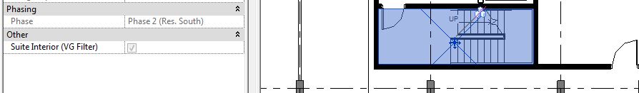

Hi
Has anyone ever had this problem and if so a solution.
In a project we used to have 2 phases. We have combined everything into one phase "new construction"
And got rid of the other phases.
But there are still elements that have the old phase.
iS the only solution to change and each and every element to the correct phases.
Also for rooms how can we change all the rooms to the new current phase.
Right now we are just recreating the rooms. Counter productive?
If anyone has gone through this problem any help would be appreciated

JD24
Joined: Fri, Jun 10, 2011
22 Posts
Hi I attached 2 jpg.
One showing it say phases is phase 2 (res. south)
The other is the phases option.
Showing just new construction.
It still exists.

Thu, Mar 20, 2014 at 2:04:50 PM | Ghost Phases
So is there still other information you have not told us?
Do you have design options?
Are any of these elements in groups?
Thu, Mar 20, 2014 at 2:28:47 PM | Ghost Phases
#9
JD24
22 Posts
HI
So there is 2 design options. Both of which do not have any of the elements in them.
ok so...
on the view when I change the phase to new construction the old one disapears from the options to put it back onto the old phase. And you can't change it back unless you undo everything.
This also happens when I change the schedule showing all the rooms that are in the phase to new construction.
When I try and change the room phase it is greyed out to saying the old phase is still there.
So all I want to do is take those rooms that are in the old phase move them to the new construction phase

Mon, Mar 24, 2014 at 5:08:46 PM | Ghost Phases
#13
JD24
22 Posts
HI
Got a response from Autodesk on this issue.
And they have it being logged with their development team for a resolution in a future release.
So hopefully in the new Revit this will be fixed.
