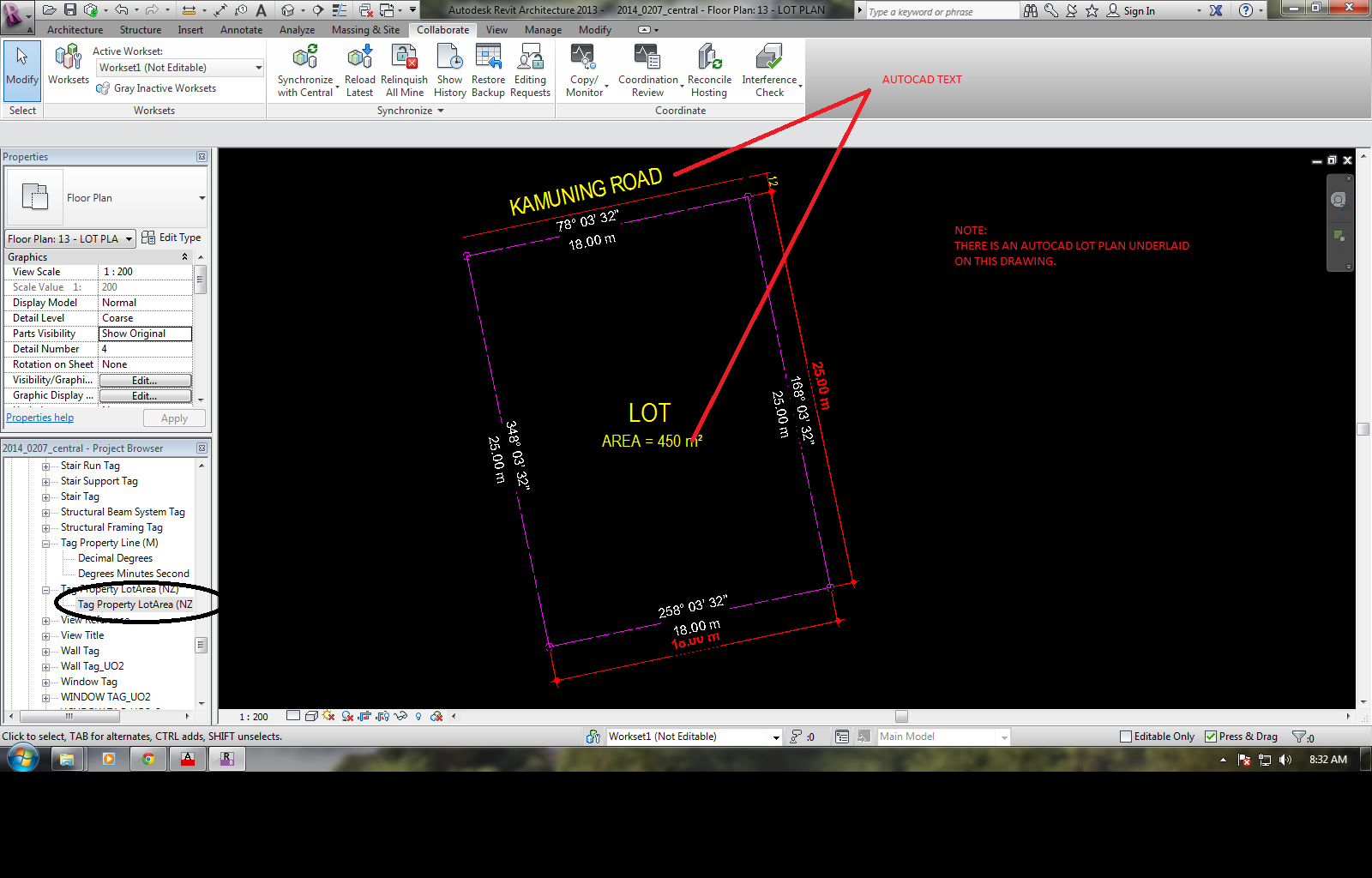

Hi Guys,
I'm having difficulty labeling my lot plan with the PROPERTY LOT AREA TAG.  It won't show on the drawing area when I drag the tag from the Project Browser (Families) and hover it within the boundary of the Lot.  Am I missing something here?
And one thing more, what tool will I use to label the lot like the street / road names, the adjacent lots, etc.  Should I simply just use the Text tool or there's a better way?
Also, i need to label the survey points of the lot. How can I do that? I'm clueless.
Hope to hear from anyone.  Thanks.
P.S. Please see attached file.
Wed, Mar 19, 2014 at 7:33:52 AM | LOT PLAN
Are the property lines in Revit - or just the CAD dwg?
In VG / annotations, do you have property tags on?
Yes - use simple text for non-taggable items like street name.
If you Survey point is correctly set, you can tag poits with the spot coordinate tag.

Thank you very much WWHub.  I didn't know it was that easy.
