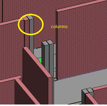

why  the column  taken the brick material and how can I isolate the material from it?

This has been posted a couple times, a little searching in the forums would have given you something like this "The standard "column" is more like a pilaster and it will assume the wall material.  Use a structural column and define its materials as you would like."

Can I change the material of coulumn or not?

Did you read my post????
"Use a structural column and define its materials as you would like"
