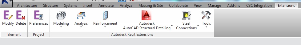

Have you tried using the Autodesk Revit extensions for RC? You need to download it I think, but it's pretty handy.

You can find and download the extension from subscription center: http://subscription.autodesk.com
However, starting this year Autodesk also put some extension on Autodesk Exchange app storehttp://apps.exchange.autodesk.com/RVT/en/Home
You may want to check both sites.
