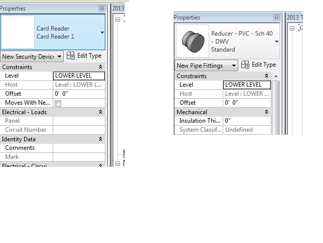

Hey guys you know how the system families have little preview pictures when you pull down the menu?  How can I get my custom families to have a preview picture?
In the attached pic, my card reader family has no prevew and the other one does.

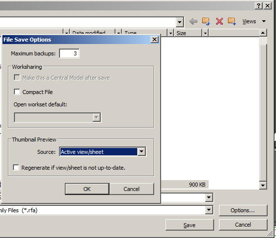

You can set this in the family when you save it .... under options.
