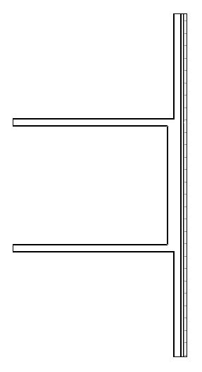

I have two different walls that align on the exterior. Some have windows, therefore the wall finish wrapping is turned on. But when the two walls come together, both show the finish turn in. The walls are joined. Please let me know if there's a way around this.
Thank you!

Turn off wrapping at ends, only need it at inserts

Any idea why the walls move when I include the wrapping?
Thu, Mar 6, 2014 at 7:20:40 AM | Wall finish wrapping at two different walls that intersect
Wraping at ends doesn't matter here.  The walls don't appear to be joined at that 'T' on the right.  Click on the upper wall and make sure wall joins is turned on at the end of the wall.  (Blue button)

The exterior finish would not clean up if the walls weren't joined so that is not it either.  I would pull the wall ends back so they are disconnected, turn off the default wrapping at ends, make sure the walls are lined up where they need to be and then connect them again.  Post a pic again if needed.  Another thing to look at could be the wall assembly priorities.

I do see that the exterior finish is joined but end wrapping is still not applied here.  It appears that the definition of these walls do not pay attention to layer function.  This user needs to read this section in his HELP>
Applying a Function to a Layer of a Compound Structure
