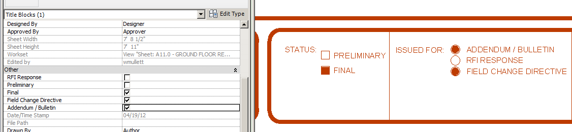

Hi,
is there a way to insert checkboxes to templates so you acan just tick them on/off, just like a radio button? Basically it is to fill a imported pdf form IN Revit.
Thanks a lot,
-O.
Wed, Mar 5, 2014 at 10:07:38 AM | "Radio-button" checkbox
You can't import a PDF so I'm not sure what you mean.
If you put a yes/no field in a family, it will show up as a checkbox in the project.
Wed, Mar 5, 2014 at 10:25:10 AM | "Radio-button" checkbox
ollmc
Joined: Thu, Feb 27, 2014
0 Posts
Well, I did export the pdf as a jpeg, then imported it in revit. The goal is to add little boxes that we can chek or unchek, so it visually fills the form.
thanks,
Wed, Mar 5, 2014 at 10:42:36 AM | "Radio-button" checkbox
Again .... if this is a family, you can do it.
We have a titleblock family that has radial buttons.  You don't fill it out on the sheet though.  You check it in the properties.
Wed, Mar 5, 2014 at 12:27:32 PM | "Radio-button" checkbox
ollmc
0 Posts
I see,
I already figured out how to do it w/ the properties...I wanted to know if there was a way to fill it on the sheet, so it can be more intuitive for the user.
Thanks for answering!
