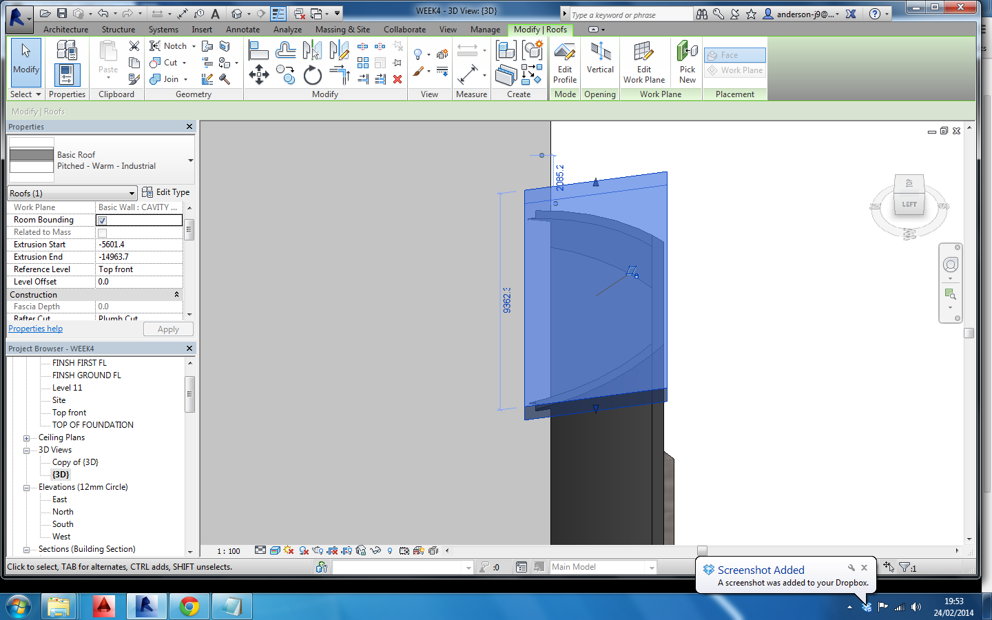

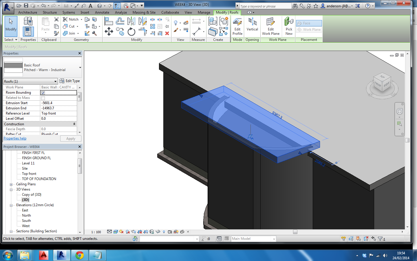

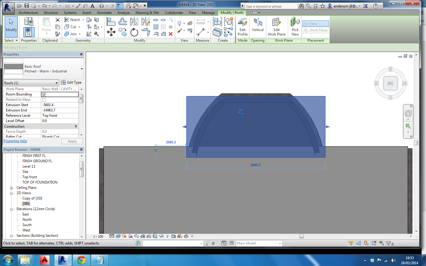

Having problems getting a roof to look the way i want it. i want the roof to be at a slope and follow the shape of the wall so basically want the two front corners to be curved like the wall. wondering if anyone knew how to do this.

Sketch your roof in plan.  If the entire roof ends up as an arc, you can add a slope arrow to get your slope.
