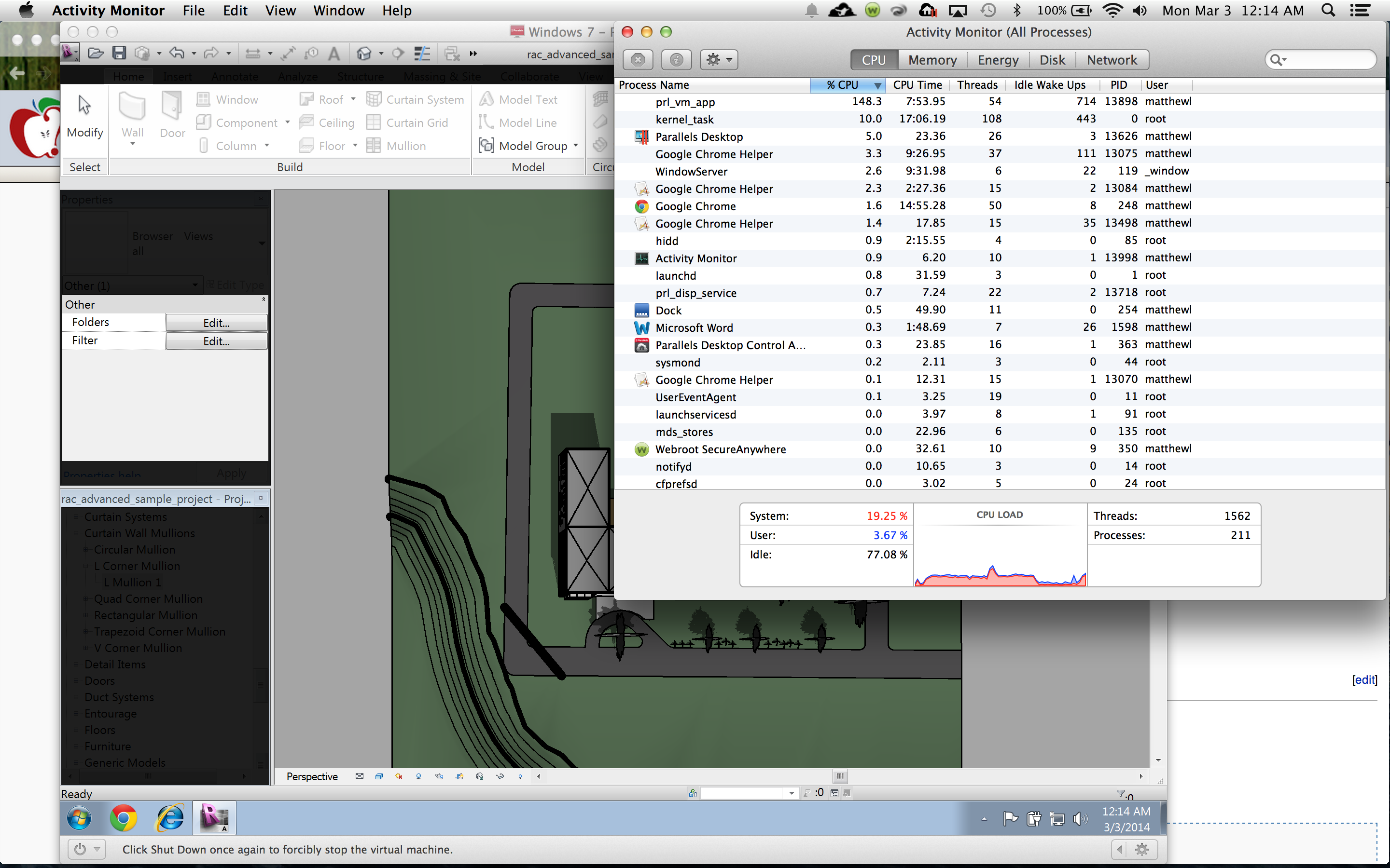

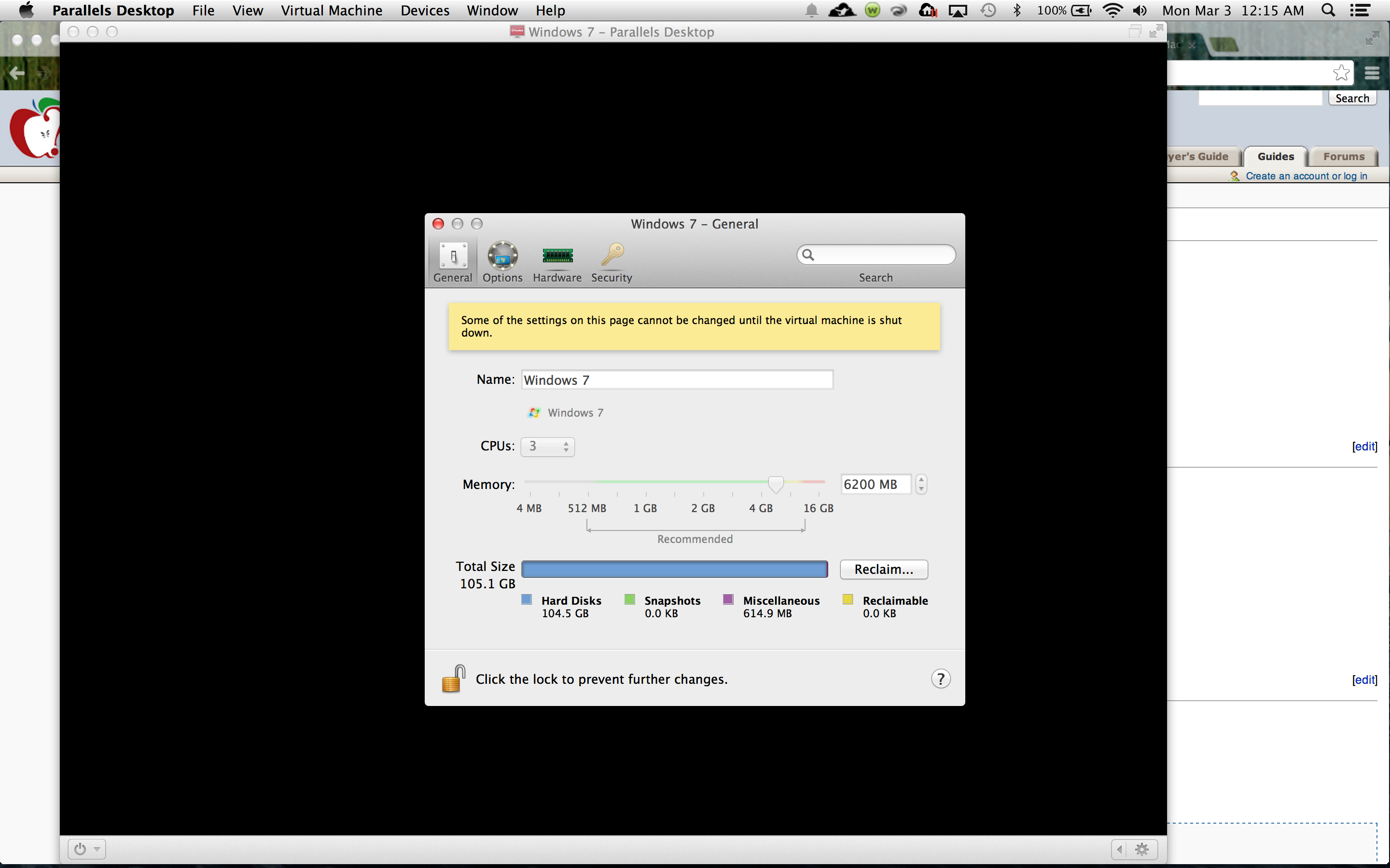

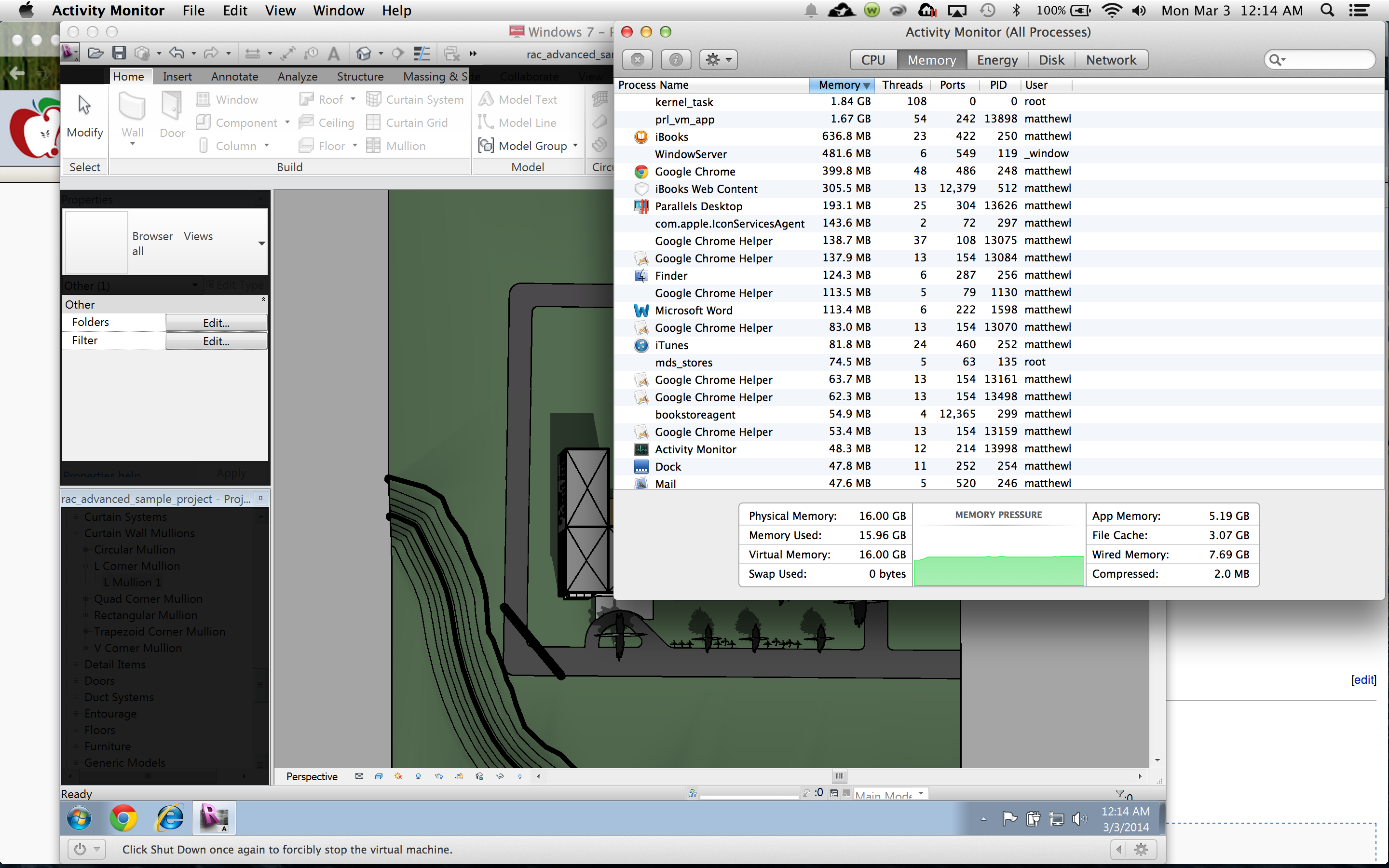

Right now I'm trying to run Revit on Parallels 8.0, I can open Revit and select the sample project, but it doesn't want to open fully. I have to run the cursor across the ribbon bar for anything to show up and wait a long time for the drawing to load.
I have been reading that most people that use Revit with Parallels on a 4gb or 8gb ram mac are doing fine so what's my problem?
P.S. Also when I do run it the computer feels like it is going to melt.
The attachments might help some of you understand what is going on.
129281_Screen_Shot_2014-03-03_at_12.14.21_AM.png129281_Screen_Shot_2014-03-03_at_12.14.43_AM.png129281_Screen_Shot_2014-03-03_at_12.15.06_AM.png

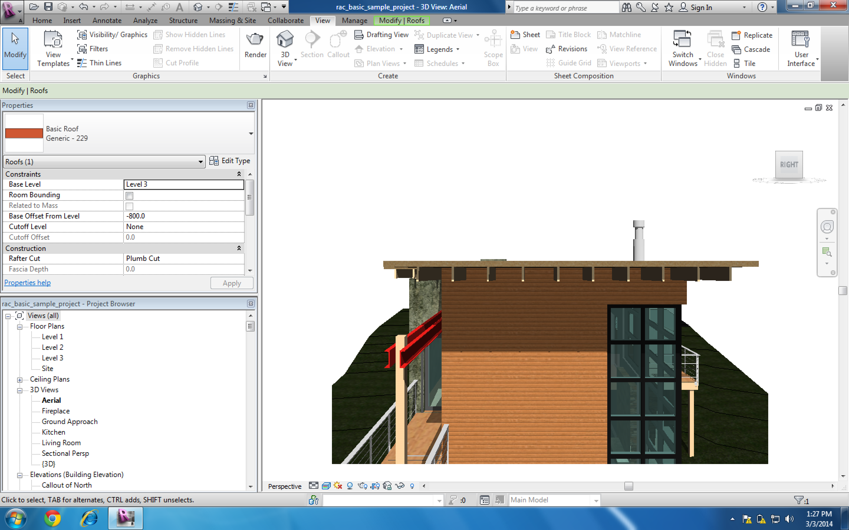

For anyone running a similar set-up. The answer lies in your resolution configuration of parallels. You need to change it from Best Retina to Scaled.
To configure, open a parallels window, then open the gear in the bottom right corner, click the hardware tab, then the video tab on the left and then scale.
