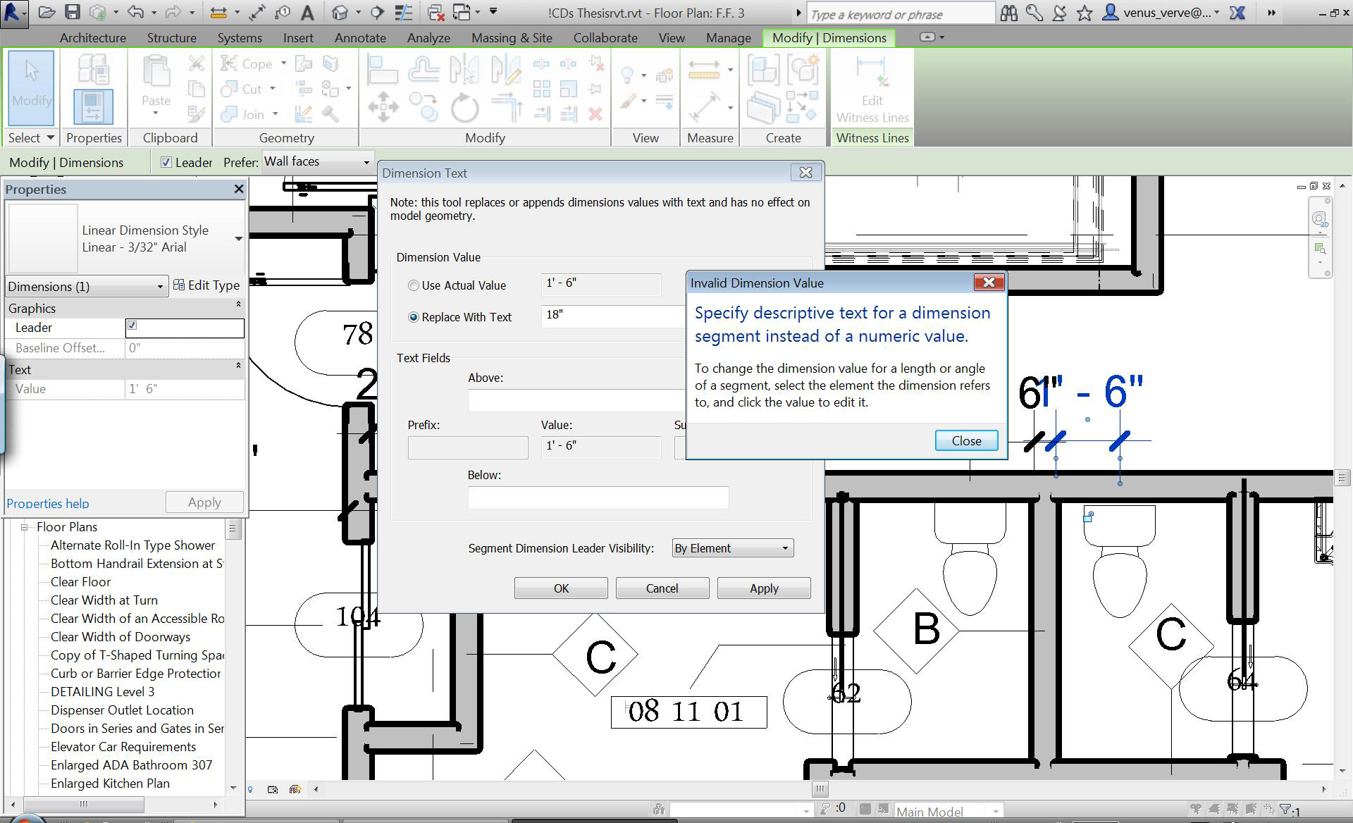

Please see attachment.
I cannot figure out why it won't work, perhaps becuase I have the dimensions set to the closetes inch?
Thanks
Veronica
Thu, Feb 27, 2014 at 7:13:14 AM | Dimension Inches w Replace text not working
Revit does not let you "cheat" dimensions and that is what it thinks you are doing.   Create a new dimension style that is inches and use that.
