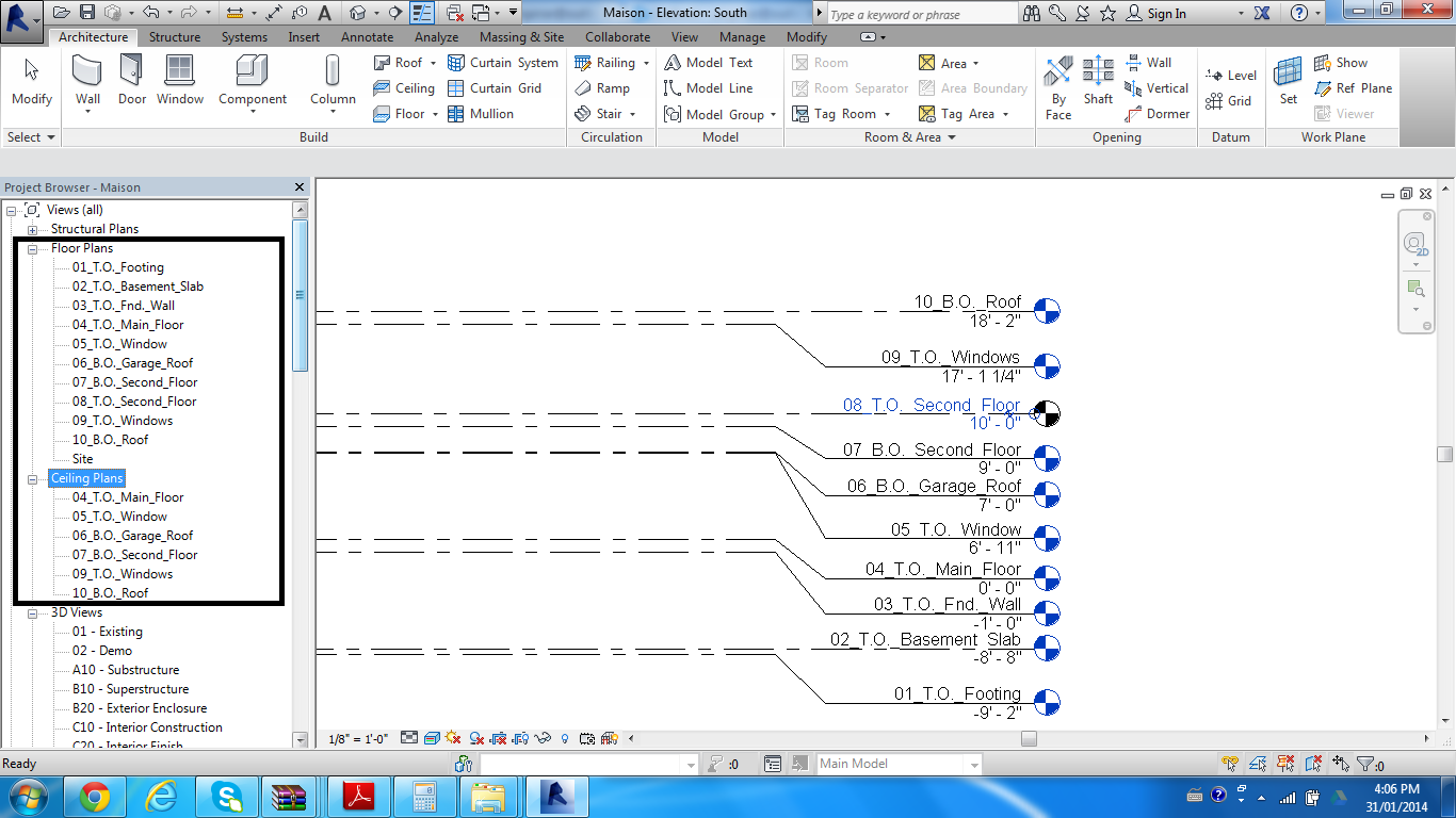

I have a bunch of different levels and almost every one that i need a ceilling plan view for is not showing up. How do i add them?
From the picture you can see that the T.O. Second floor and T.O. Basement slab ceilling view is missing and i nedd thoses
Thanks
Wed, Feb 26, 2014 at 7:31:12 AM | Ceilling plan views
You need to find some fundamental training resources .... one of the books would help you with this very beginning question.
Click on view / floor plans / reflected ceiling plans and pick your levels.
