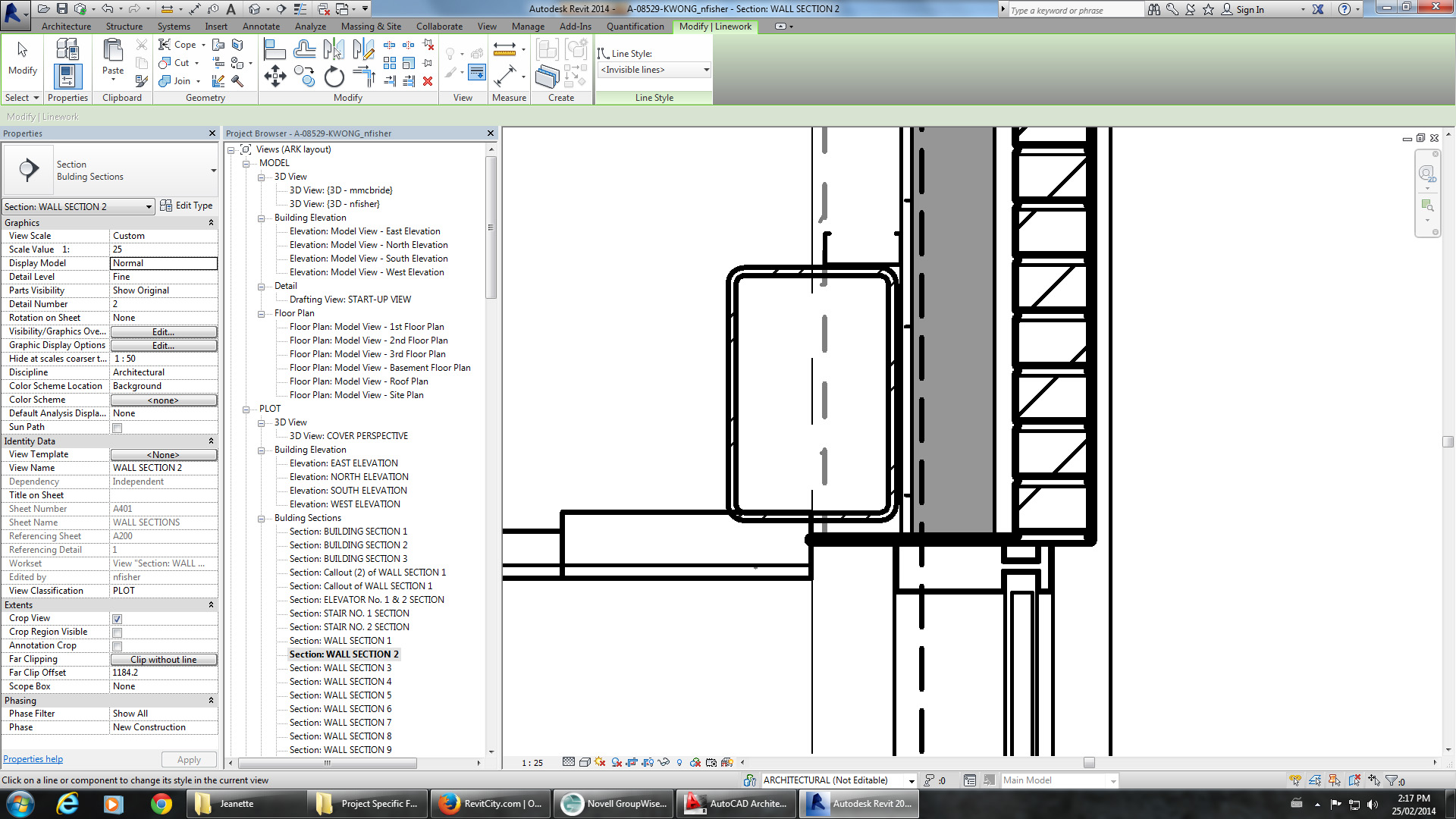

I am trying to turn some lines within a wall assembly (common edges) to invisible, when set to invisible using the linework tool, common edges display as a dashed grey line and they also print as a dashed grey line. See image attached, I am trying to hide a stud backing wall from passing through a box beam.
I have no overrides applied to wall common edges through v/g overrides.
Has anyone have an idea why this is happening?

There are two lines at every common line location and sometimes this process just doestn't seem to work.
Use edut cut profile with the edit line out of your view range.

Thanks WWHub, I hadn't thought about the cut profile tool for this process which works well for section/plan details. For wall sections I just thought to create a white line type to override common edges with using the linework tool and it seems to do the trick.
Cheers,
Nate
