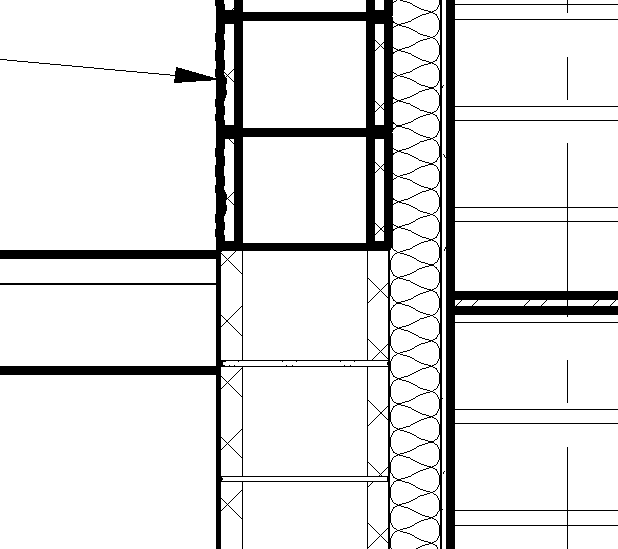

I have two detail items (split-face cmu & cmu sections.) within each family it says the line is "Heavy Line." and the lineweight is set to 5 for both. yet on the computer screen and when it prints out one of the detail items is thinner than the other? how to correct?
Tue, Feb 25, 2014 at 1:49:38 PM | line styles not reading/ printing the same
Are both detail families?  Both have the identical detail line type?  "Heavy Line" does not equal "Heavy line".
Is there a masking region or hatch in one or both families?  Not all detail creators are equal and they place regions over linetypes.  No reason to have a line if the region is defined correctly.  << This is probably your problem
Tue, Feb 25, 2014 at 1:57:57 PM | line styles not reading/ printing the same
ledgewood33
Joined: Wed, Jan 27, 2010
34 Posts
5 Stars: 1 Votes
I checked for masking regions and linework. none existing in either family. both families are "out of the box" from revit. if possible I will try to attach each family or at least an image of the two conditions.
Tue, Feb 25, 2014 at 2:11:39 PM | line styles not reading/ printing the same
The families are OK.
Did you create this drawing?
Is the lower element overridden perhaps?
As a side issue.....Did you know that you can control these lineweights through the manage object styles? ...or by view in VG - The heavy lineweight seems to be too heavy.
Tue, Feb 25, 2014 at 2:58:27 PM | line styles not reading/ printing the same
ledgewood33
34 Posts
5 Stars: 1 Votes
so I think I came up with a solution or at least a work around. I clicked on the detail item that wasnt show the proper line weight and the clicked on edit type. within there I unchecked the core visibility and hit ok. i repeated the same steps and checked the core visibility and the line weights are reading properly now.???
