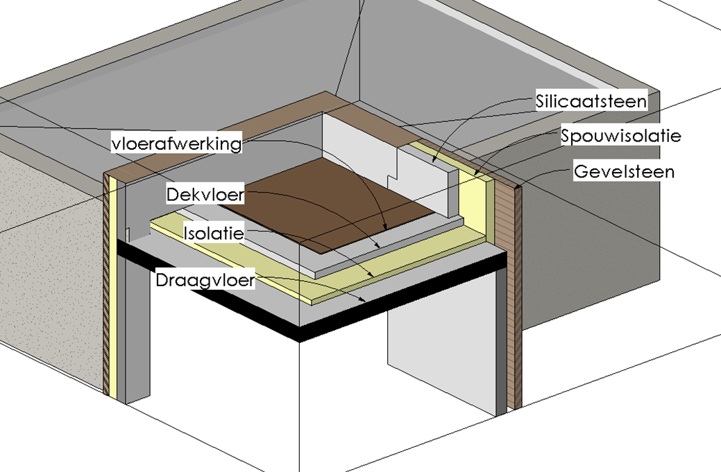

Mon, Feb 24, 2014 at 6:19:58 PM | How to explode anonmeetric walls for detail drawings
CinnamonBird
Joined: Sun, Oct 7, 2012
0 Posts
1 Stars: 2 Votes
the video didn't help.  I have attached an image of what I mean by axonmetric explosion.  I need to draw this in recit.
How would I go about it?
thanks

Tue, Feb 25, 2014 at 3:56:33 AM | How to explode anonmeetric walls for detail drawings
Joined: Tue, May 22, 2007
5921 Posts
4 Stars: 205 Votes
You have to use "Parts" : http://help.autodesk.com/view/RVT/2014/ENU/?guid=GUID-FF4B3E7D-0804-4EE4-9384-C78255B5480C
Tue, Feb 25, 2014 at 7:35:20 AM | How to explode anonmeetric walls for detail drawings
You need to watch the video I pointed to again and be creative in your thinking.
Parts allow you to partially hide portions of layers of a wall, for instance, in a view to reveal sub layers .... exactly what you want.

Here are a few blogs that may help:
http://grevity.blogspot.be/2012/04/breaking-up-is-hard-to-do.html
http://synergiscadblog.com/tag/revit-parts/

My final attempt at explaining this to you.
Watch the youtube video below, it explains how to divide your wall into parts and adjust the layers.
http://www.youtube.com/watch?v=R3JeYe9s7Po
If you still don't get, I suggest you just model it in SketchUp. Although it's really not that hard in Revit.
