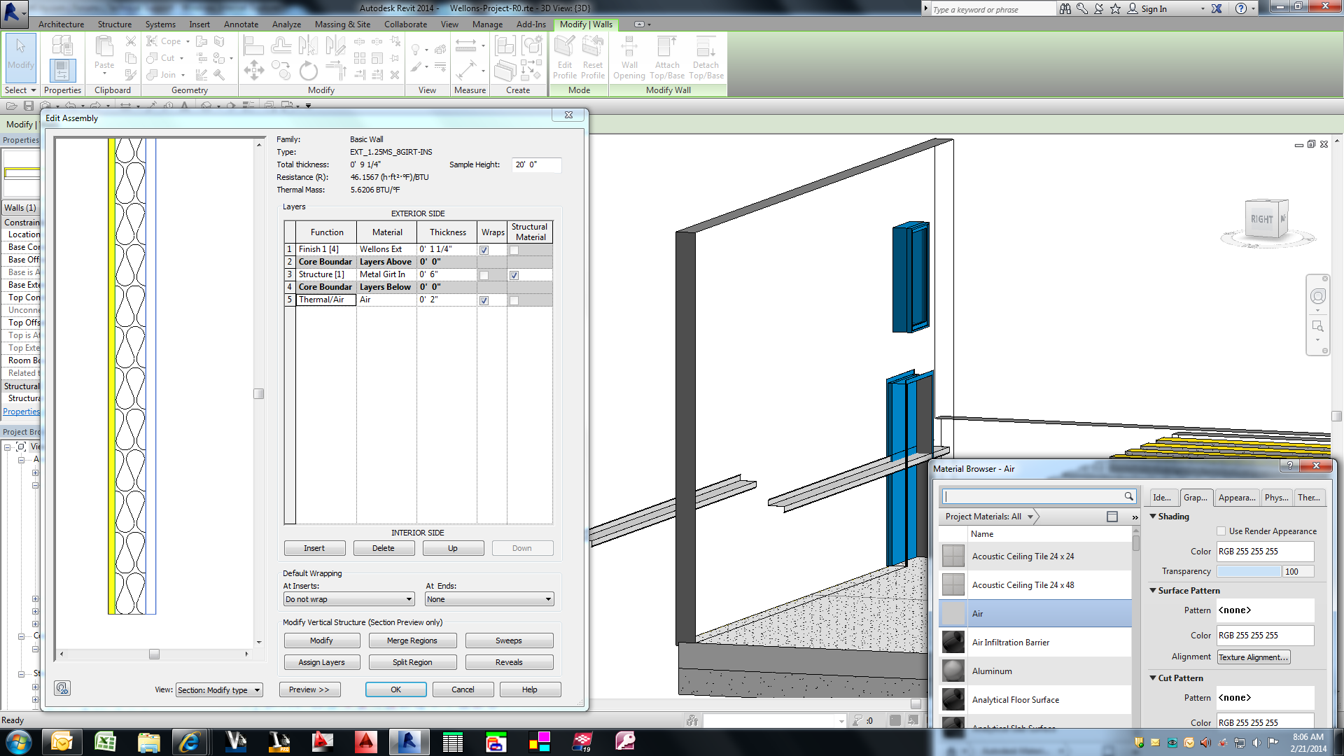

I created a wall with a 2" air space on the inside so my girst will show in the 3d views. My problem is the whole wall is transparent from the inside view.
How do I make the wall only transparent for the 2" air space. If i shrink the wall by removing the air space then the wall thickness is incorrect in plan and section.
Intent: To see only 2" of the 8" girt in the wall fron the inside in a 3d view. Marketing wants shaded views.
Edited on: Fri, Feb 21, 2014 at 10:09:38 AM
Fri, Feb 21, 2014 at 10:40:56 AM | Walls with 2" airs space on inside, whole wall is transparent form insed view?
Do it has two walls that are joined and turn off the inner wall in your 3D view.

Do you mean add a second wall behind the first?
Wed, Mar 12, 2014 at 3:45:22 PM | Walls with 2" airs space on inside, whole wall is transparent form insed view?
chilie
Joined: Tue, Sep 27, 2011
2 Posts
Try making the air material transparent in the material editor itself. There is a "Transparency" option in the material editor assuming you have the correct material properties picked in the first place. Its on the "appearance" tab of that particular material.
