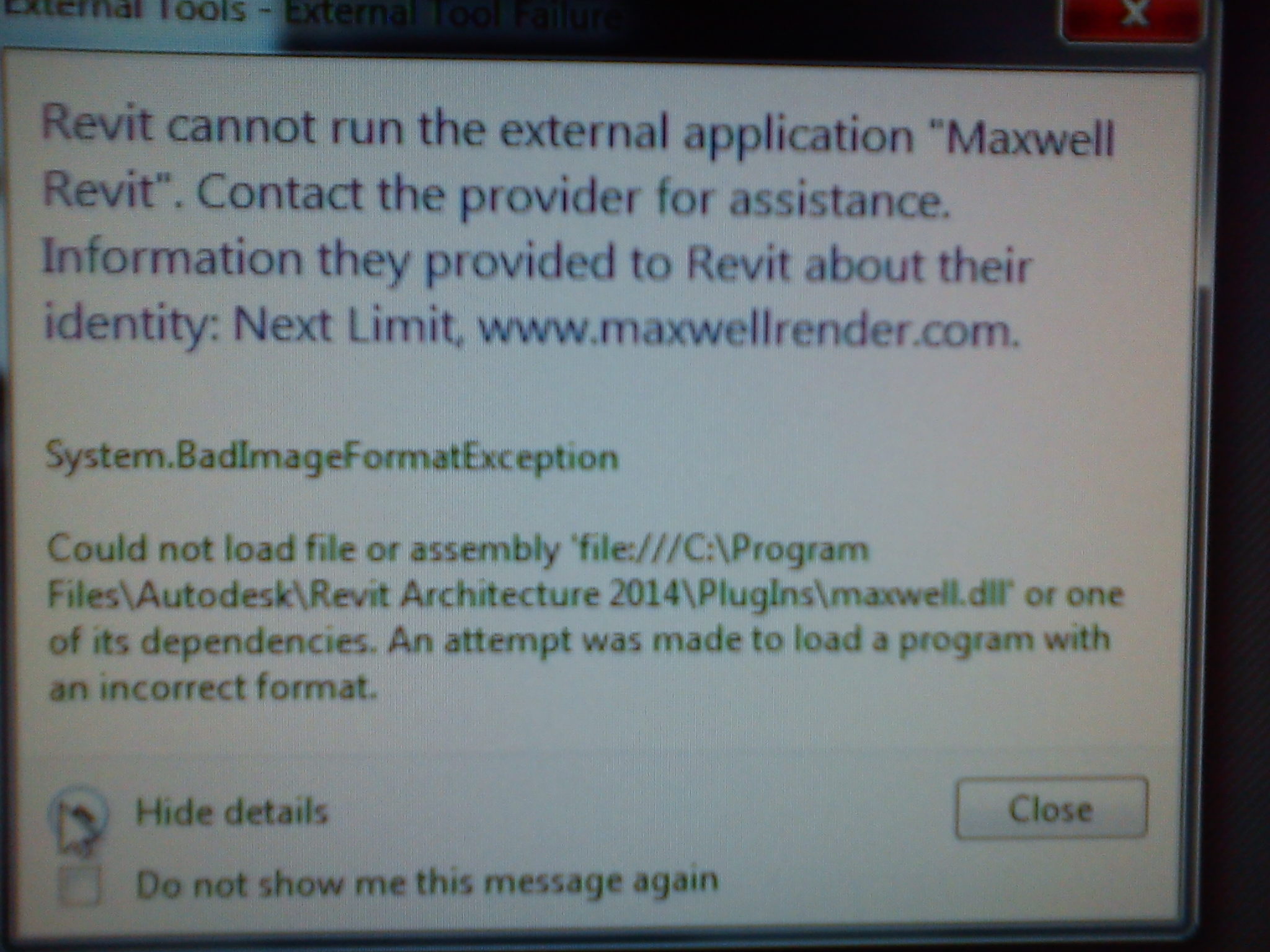

I downloaded the maxwell plugin for revit 2013, but when i open my file in revit a message comes up saying that maxwell is missing a file called ''maxwell.dll'' . When i went to check the location that it mentioned the file was there... any help?

Try reinstalling the plug in, or try contacting Maxwell.

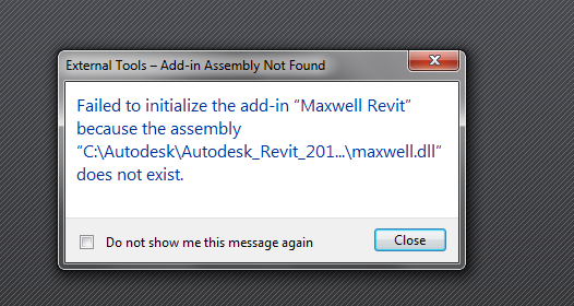

I downloaded the maxwell plugin for revit 2014.
Wh
Thu, Jul 3, 2014 at 2:01:22 AM | maxwell installation error!!!!! sos
world313
Joined: Thu, Apr 25, 2013
0 Posts
I downloaded the maxwell plugin for revit 2014. but when i open my file in revit a message comes up saying that maxwell

This is because wrong Maxwell installer. Try to add slash in end of installing path.
Before:
C:/your_path_to_revit
After:
C:/your_path_to_revit/
