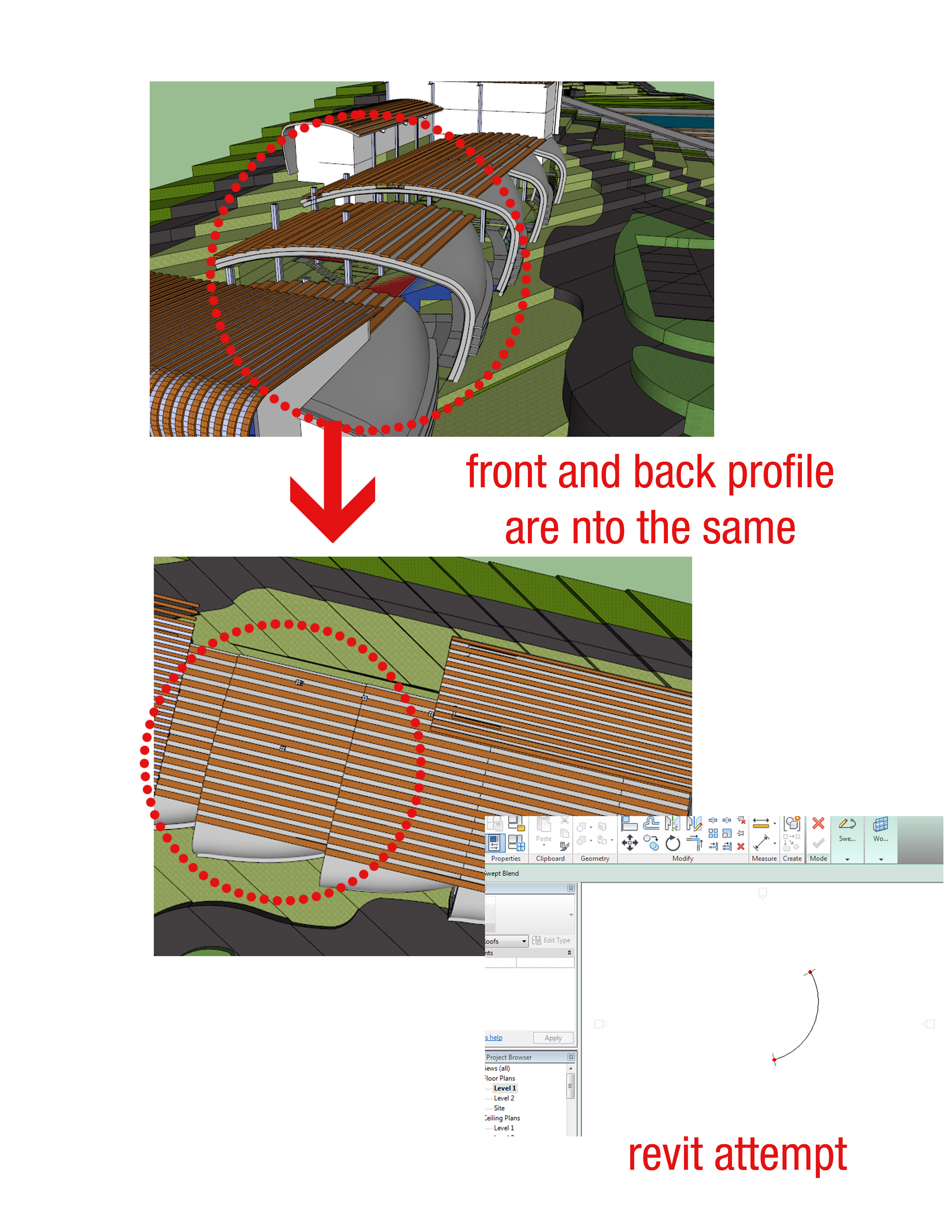

hi all,
I've got a problem with massing.  I'm trying to achieve a  mass roofing (attached here for reference) by using swept blend however, i've noticed that the reference plan is perpendicular to the profile. my questions are:
a.) is there a way to change the reference plane of the profile for swept blend(i want it to face the  default 'elevations' in  revit
b.) what is the best way to achieve this kind of massing in revit?
thanks everyone! hope you could help Smile

Instead of a mass, did you try just doing this in-place, swepth blend, roof category?

thanks WWHub for the advice, upon doing so i still got the same problem i can't modify how the reference plance works.  It is still perpendicularto the profile.
why my massing can't not be a solid?
