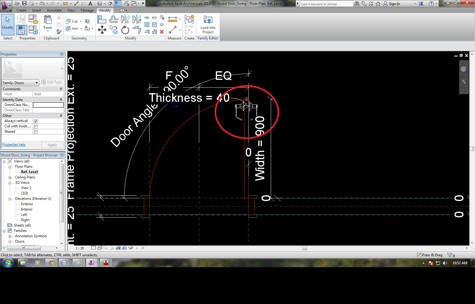

Hi Guys,
Here I am again, asking questions.  I'm a newbie on Revit so I have no choice but to keep asking anyone whom are helpful & knowledgeable on this software.  Hehehe.
Anyway, how can I make the door knob move along the door panel as I open it?  The door knob is another family that I just loaded to my door family.
Bytheway, which family template should I choose if i want to make my own door knob?
please see attachment.
Thank you to all.
Thu, Feb 13, 2014 at 7:25:33 AM | DOOR KNOB ISSUE
If that knob is another family, you should be able to lock it to the face of the door.
Is it a face based family?

actually I don't know.  How would I know if a family is created on which template? I only downloaded that doorknob from here, on ReviCity.
I attached the door knob family I used.
Thanks again WWHub.
