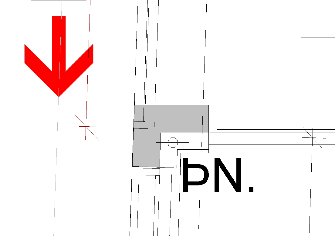

Im having problems over and over again with curtain walls joining into external and internall walls
See pic
any suggestions?
Wed, Feb 12, 2014 at 9:30:31 AM | Curtain wall with external wall join
Click on the CW and turn off wall join for that end of the wall.

How is that done? I cant see the command
are you refering to the wall join tool?
Wed, Feb 12, 2014 at 11:35:06 AM | Curtain wall with external wall join
If you click on any wall, you will see a blue dot at the end.  Right click on that and you can turn off wall joins.

Brilliant, worked like a charm
