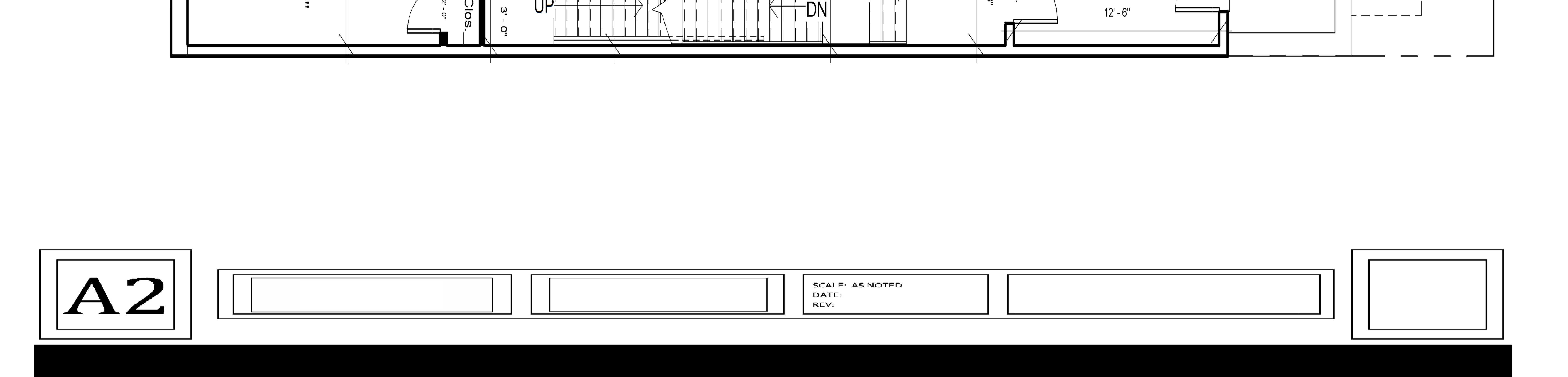

I have a project with multiple sheets, and I have been exporting them as images. 3 of my 4 sheets print well, with my titleblock included, but on one of my sheets, the titleblock always ends up wrong. On this sheet, after eporting the sheet as a Tiff, like all the others, the titleblock shinks by 50% horzontaly, giving me a titleblock that is really thin, and out of proportion. This resizing leaves a large black spot where the titleblock should be. The titleblock on this sheet was made the same way as the others, just a blank 24x36 sheet with the image of the titleblock imported in.
I have put my A2 titleblock (the one that doesnt export right) onto another sheet, and it has worked. I guess this means it isnt a problem with the titleblock file, and it must be related to the GV settings or somthing.

I see no reason for this happening but I have seen corrupted sheets.  Make a new sheet and move all your views to that.  Does it work now?

Weird, I just switched my A2 titleblock (the one that was being weird on the sheet) to an A3 titleblock (which I have already done before, with no luck) but this time it worked, and the A3 titleblock was fine. when I put the A2 back on it worked fine. Im not sure why its working now, but it is.
