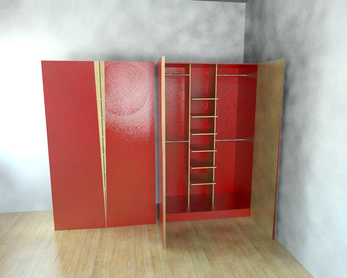

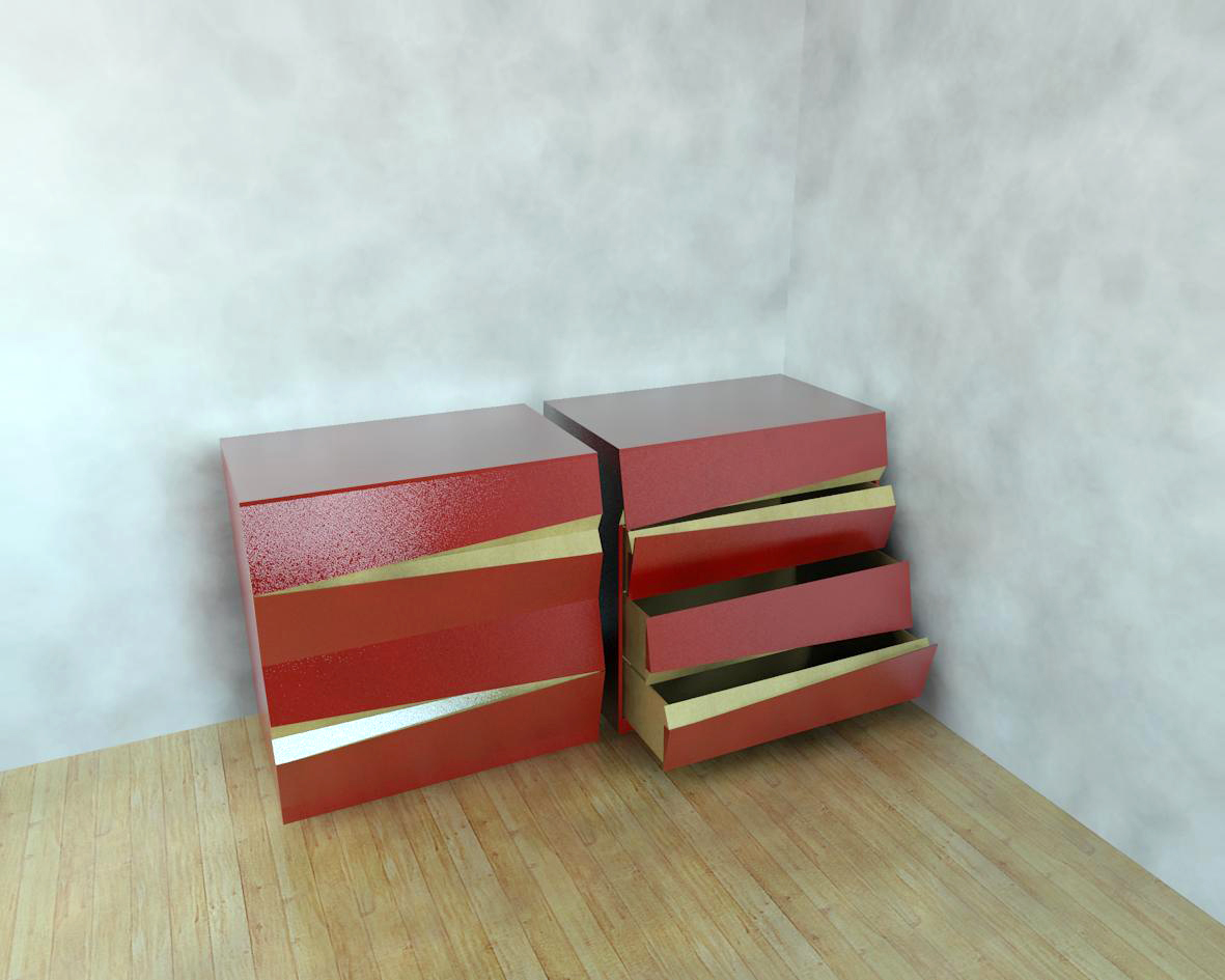

Hi there,
I'm designing a couple of furniture ranges in Revit 2014.
I was wondering how I would go about creating instances with drawers/doors open and closed, so far I've had to
create separate families. I have a basic understanding of how to create instances, but not had any luck with this.
See the attached image for an example
Cheers
Wed, Jan 29, 2014 at 7:29:49 AM | Creating open/closed furniture instances
You can have two different solids in your family for your doors - one open, one closed - then you set visibility of those based on a new parameter that you create.

so for the drawers I'd just alternate the visibility settings? or would I be able to make a 'placement' parameter? or just simply create a new instance and move the elements?
Wed, Jan 29, 2014 at 10:07:06 AM | Creating open/closed furniture instances
The visibility setting can be a type based or instance based parameter.  The controlling parameter might be a T/F parameter like OPEN and the visibility setting can be an IF....
Search the forums for similar threads.  Also download the families guide from the autodesk site.
