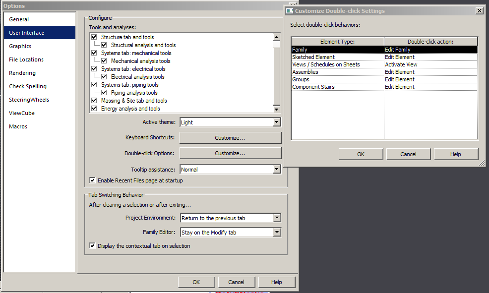

After I put drafting views of our typical details on a sheet I like to move them to align them perfectly. If I click on one of the details too fast the rest of the sheet goes to grayscale except the detail I clicked on. This is a nice feature giving you the ability to edit the detail on the sheet without having to go to the drafting view. However, I would like like this feature to be disabled. Can anyone tell me how to do this?
Tue, Jan 28, 2014 at 8:20:16 AM | Revit 2014 On sheet detail editing
Your double click options are set under the Revit R dropdown - options.
Tue, Jan 28, 2014 at 8:25:55 AM | Revit 2014 On sheet detail editing
mark7321
Joined: Sun, Nov 8, 2009
28 Posts
Got it. Thank you very much.
