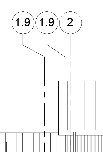

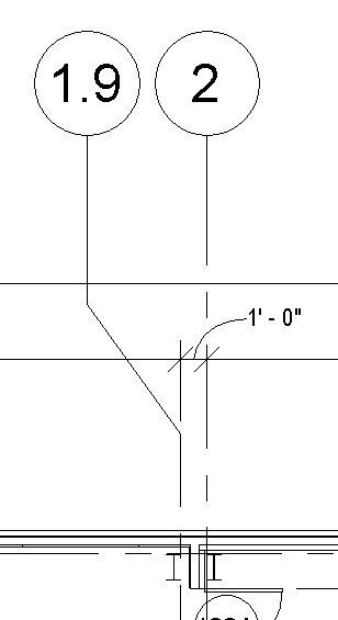

Hey all I'm new here. I have a question! I am working on a project in Revit 2013. I am working on the building elevations and I have a grid that is showing up two times. It shows up on the elevation 2 times and once on the floor plan. Also I can not delete it, it won't let me. I have provieded a couple of pictures so you can see what I'm talking about.Much thanks!

There has to be a CAD file linked in or something because you cannot have two Grid numbers be the same.  Do you have all of the updates for 2013 installed?

Hey thanks so much for the response. There is a AutoCAD link in the floor plan. But that would'nt show up in my model elevations which is a 3D view. I could be wrong. None the less. Strangely when I click either one they both become highlighted.I have not run any updates but I'm looking into it now. Thanks!

There was not just an update for 2013, there were three updates and they all need to be installed.
Your question was about grid lines yet in your post before last you said it was a 3D view.  Grids don't show in 3D views but CAD files do if they were loaded in all views initially.

Sorry for the confusion... When I said 3D view I mean't elevation view of my model. And thanks for letting me know I have to install all updates.
