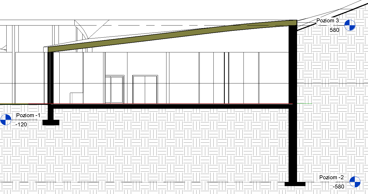

Hi, I'm using Revit 2014 Student version and have problem with creating elliptical roof. If I wanted it to be flat, it wouldn't be a problem. But I need it to be lower near the center of ellipse and higher at outer edge of this elliptical "ring". As you probably know, this "ring" doesn't have constant witdh, as it's elliptical. So I can't just define 30 degrees slope, because height at outer edge would be diffrent in every part. See attachments to understand me.

why don't you try with conceptual mass?
