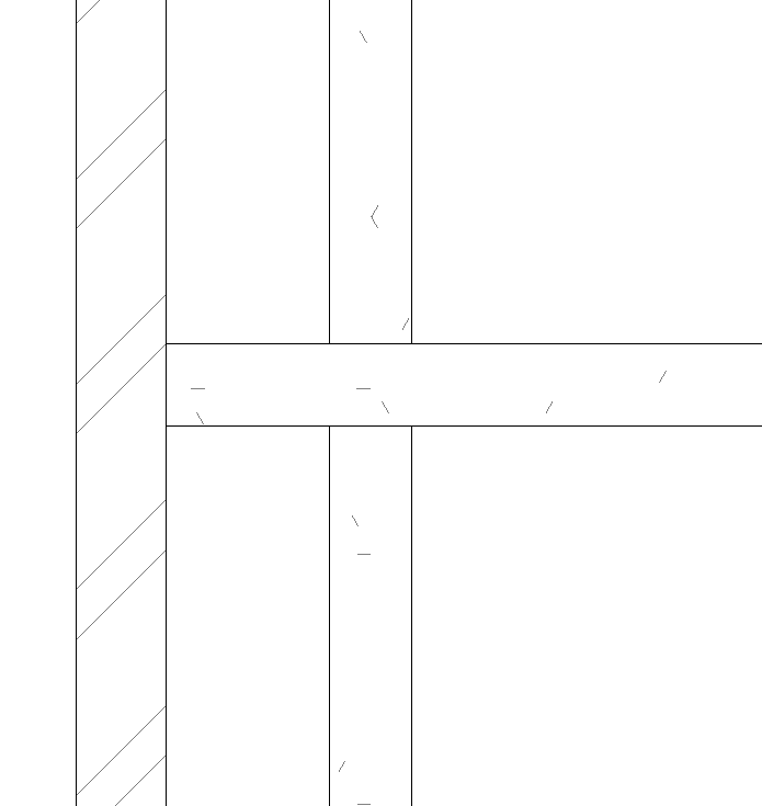

Hi,
how can I stop the concret wall at the other concret wall?

Wed, Jan 22, 2014 at 7:22:17 AM | Wall Join
Read your HELP:
"Applying a Function to a Layer of a Compound Structure"

try highlighting the wall in question.
then right click on the biggest ble dot.
then select disallow join.
then adjust wall by dragging other blue dot.
cheers
