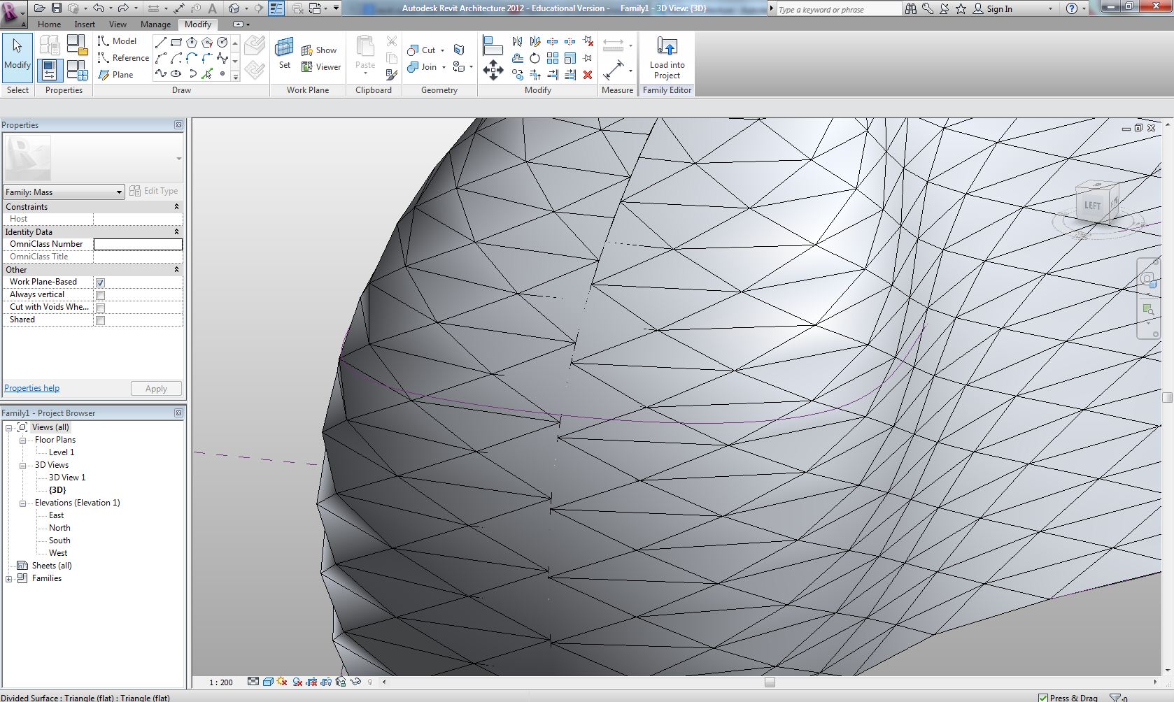

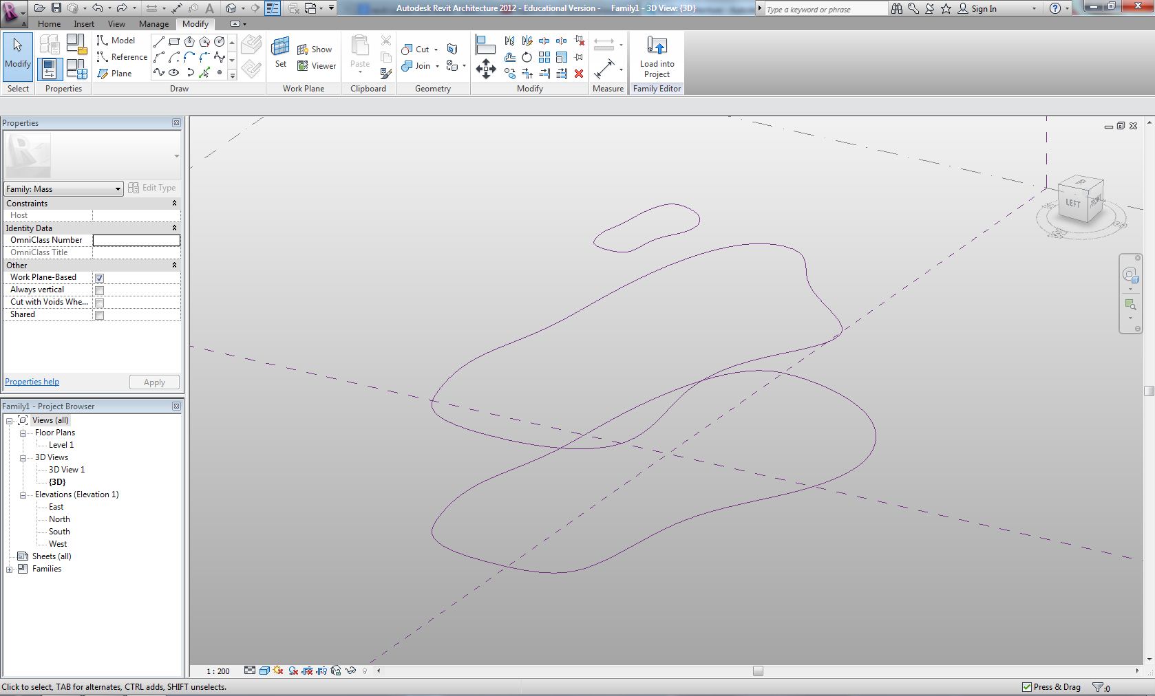

Good day everyone, I'm trying to figure out a small problem I have with creating a Blob-like form. I've created a mass by creating a form out of six (two per level) reference lines. The Form comes out nice, but whenever I divide the form, the two created surfaces don't align with eachother. Therefore, when I create curtain walls or patterns on this form, they don't match up either. I have attached two images and a Conceptual massing file with the mass inside. I Hope someone can provide me with a solution for this problem. Thanks in advance, Leo

you have to make ref. planes and use them for pattern grid axis.
this video will help. watch 1:00~1:40
http://youtu.be/GKW_hhm1HNU
