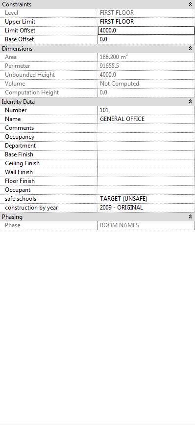

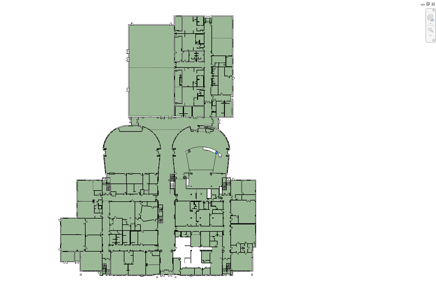

color fill scheme showing up in entire building except one room. The room appears to be the same as all others.  I have tried deleting the room and re-doing....thinking a glitch however no luck.
Working in 2014.

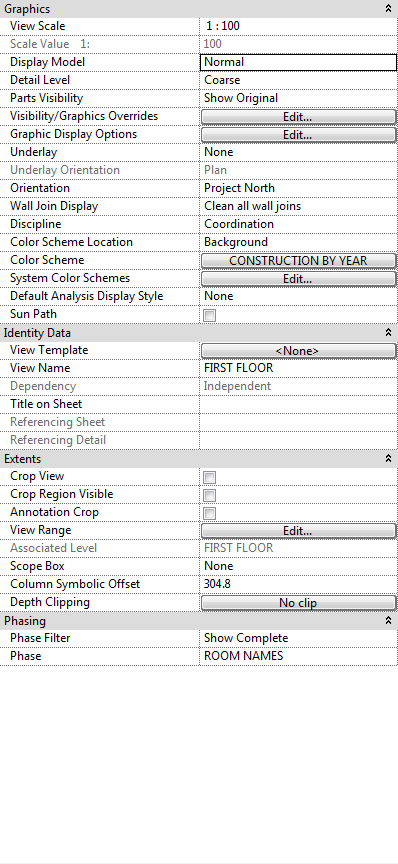

You really are not telling us enough.  I didn't ask if your phases and worksets are correct, I asked if you were using phases or design options.  So your answer indicates you are using phases.  There could be a problem there but we don't know yet.  Create a brad new floorplan from the view tab.  DON'T JUST DUPLICATE YOUR PLAN VIEW.  How does it look now.
You say it is the wrong color.... show us your settings - show us your room properties.

show us your settings - show us your room properties.  See attached.

This profession requires communication.  You have a color assigned to what?  You don't say so what you have posted is meaningless.
Are we to assume that the white space is room 101?  You don't say.
Why is room names a phase?  That doesn't make any sense.  How is that tied into the phase filter "show complete"?  Phases are typically existing - new - demolition.  Show complete would show previous - not demo'd and new.
