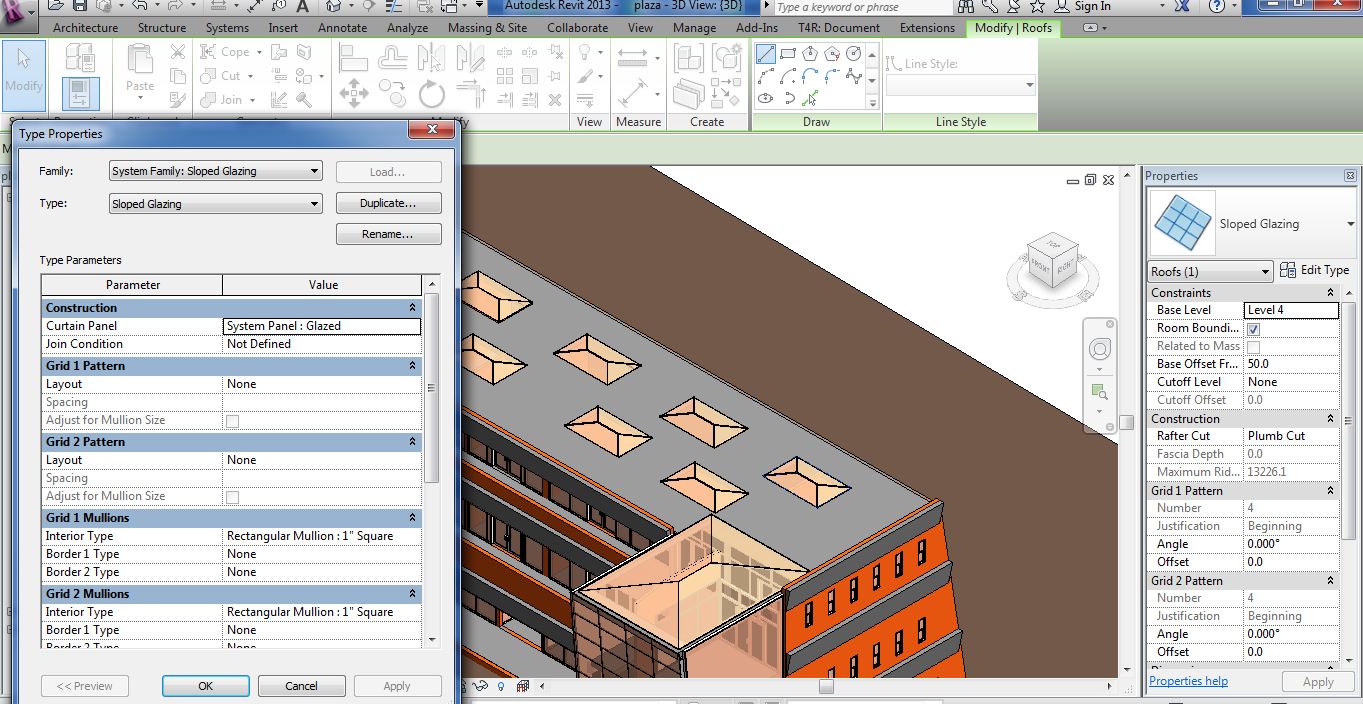

anybody could help me, i would like to apply a different materials to my slope glazing skylights, i have two skylights and they need to be in didifferent shades of glass; in revit 2013, please help me... damar_hutchinson@hotmail.com

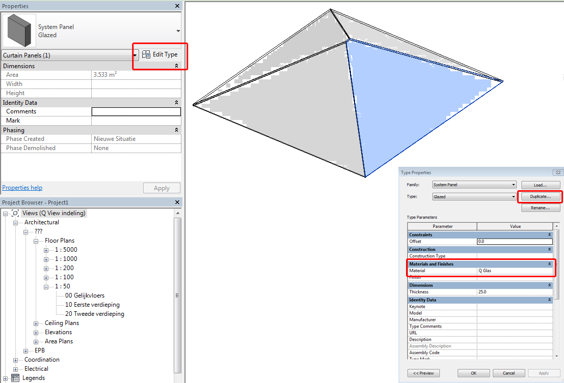

When selecting the curtain wall panel, you go to the type prooperties and create a new type.
You can give this type a different material than the other panel, thus creating skylights in different colours.

yea, thanks howvever remember i am working with the slope glazing which is a roof family

revit uses the curtain panels in sloped glazing.
When you change a roof type to sloped glazing, Revit creates a roof similar to a curtain wall.

"the material has to be changed in the objects styles"- Wrong
You need to click on the glazing and edit the type and duplicate it as KimTaurus told you to do.  You need to individually change the glazing panels.

In object style you define a material by category. This means when an element is not assigned a specific material if will receive this "standard" material. When selecting a curtain panel, you can specify a material for that panel, and create several panels each with a different material. Same goes for mullions.

Thanks guys, it did work (y).. never stop learning
