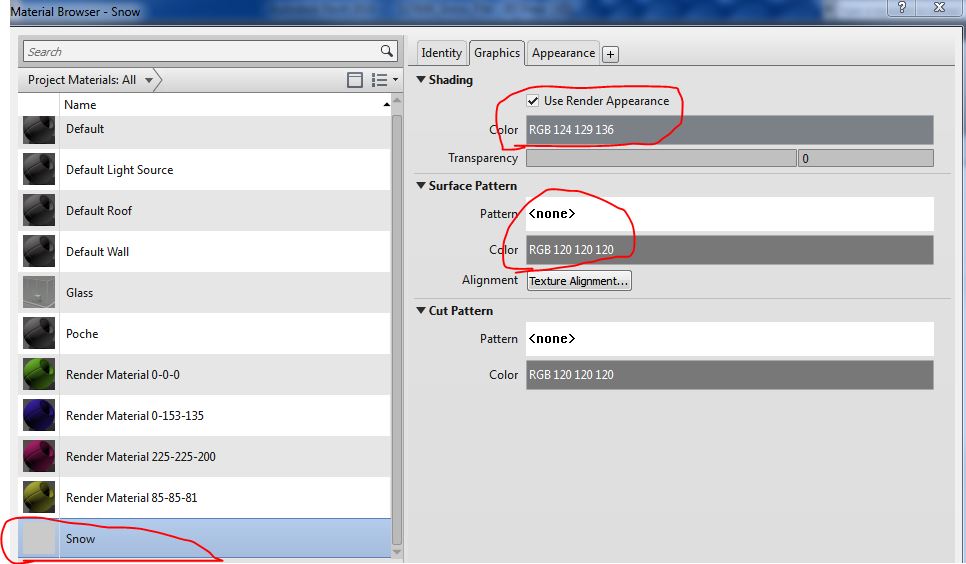

Thank you for the explanation I have taken a screen shot as you can see I changed all of the imported families to bright colours and only some sections of the components changed. Also some stayed the base grey. I tried both options that you suggested.

Your materials are set to Grey!  Look at the attached image.. you need to change the Appearance and Graphics and then once its in your PROJECT make sure that you materials are the same as your family (just double check).
