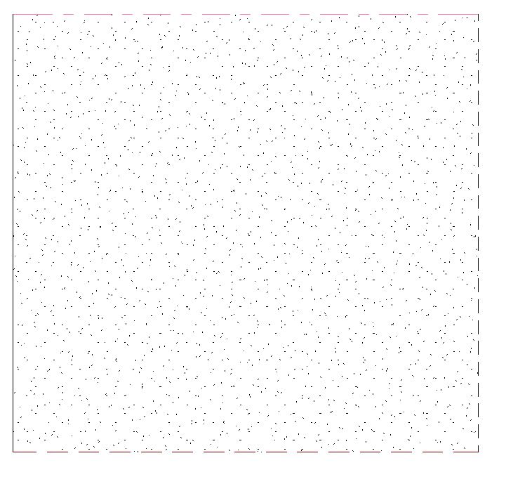

I am a landscape architect, using Revit 2014 for site work.  I am working on my first project in Revit 2014 and have an issue when I make floors transparent (any percentage) that I can't use the linework tool to change the edges to a different linestyle.  Does anyone have a fix for 0o show up.

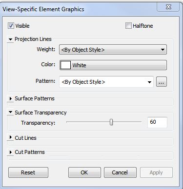

Can you attach an image of what you are trying to do?  You can use the override graphics to change the projection lines.  When I do it I can't change a line to be invisible because with the transparency you are seeing the line below.  You could override your floor lines to be inivsible (or white) and then go back and use linework to change them to whatever you want.

Here is a image of my settings for the image above.
