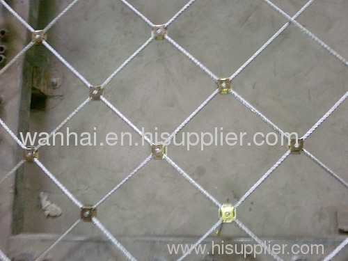

Thank you for your quick response.  Unfortunately, I cant find an exact image of what i want to do. I want to create a grid 1m x 1m and on the points and the wires meet i want to hang bamboo sticks. The wire grid is going to be fixed to the wall just above the second window. I want to hang the bamboos just like in the picture that i attached. obviously in the grid 1x1 they are going to be further away.
Imagine that this grid of wires/ropes (in the second picture) is on the ceiling.
If I am not clear still, please let me so i can make a sketch(not doing it yet cause i dont have printer/camera with me and its going to be a bit of a hustle)
THANK you so much,

I would create this as a separate family and load it into your project.

But what kind of template should i use?
Metric Generic Model ceiling based?
thank you for all your help
Thu, Jan 9, 2014 at 9:49:17 AM | Need some directions, don't know what to do
teafoe5
teafoe5 Avatar
Joined: Fri, Nov 12, 2010
1749 Posts
4 Stars: 47 Votes
Well if you make is ceiling based it has to be hosted by a ceiling, is that what you want?  I would assume just make is as a Generic Model
