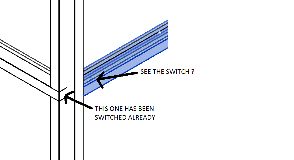

Go to a 3D view and set the join switch for the horizontals to be continuous rather than the verticals.

I'm using Revit 2013. is there some new switch that i dont know about in 2014? or are you talking about the system Join Condition Value? if so i tried that one and it didnt work
Wed, Jan 8, 2014 at 10:17:13 AM | cleanup horizontal mullion at corner mullions, again....
Look at the image attached.

not sure why that posted 3 times....that was the first thing i tried, still doesnt work
i have it set to Border and Horizontal Grid Continuous
attached is what it looks like now (i modified the mullion profile from the last image)

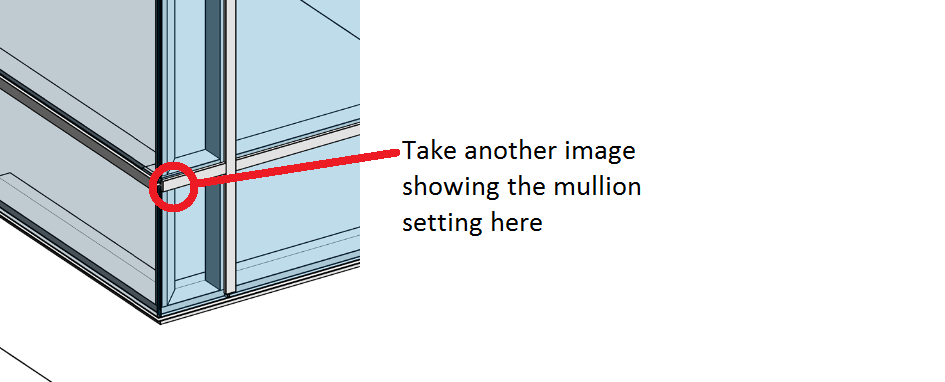

Do you have wall joins on?  Post another image showing your mullion setting where I point to.
45 degree corner mullions are a problem.  A solution may be to define the CW from the outside edge.

jsel13
Joined: Wed, Mar 5, 2008
67 Posts
5 Stars: 1 Votes
i'm not sure if this is what you are looking for. i can send you the file...
Wed, Jan 8, 2014 at 11:14:49 AM | cleanup horizontal mullion at corner mullions, again....
A small file with only this cw and everything else purged would help us see the problem.
