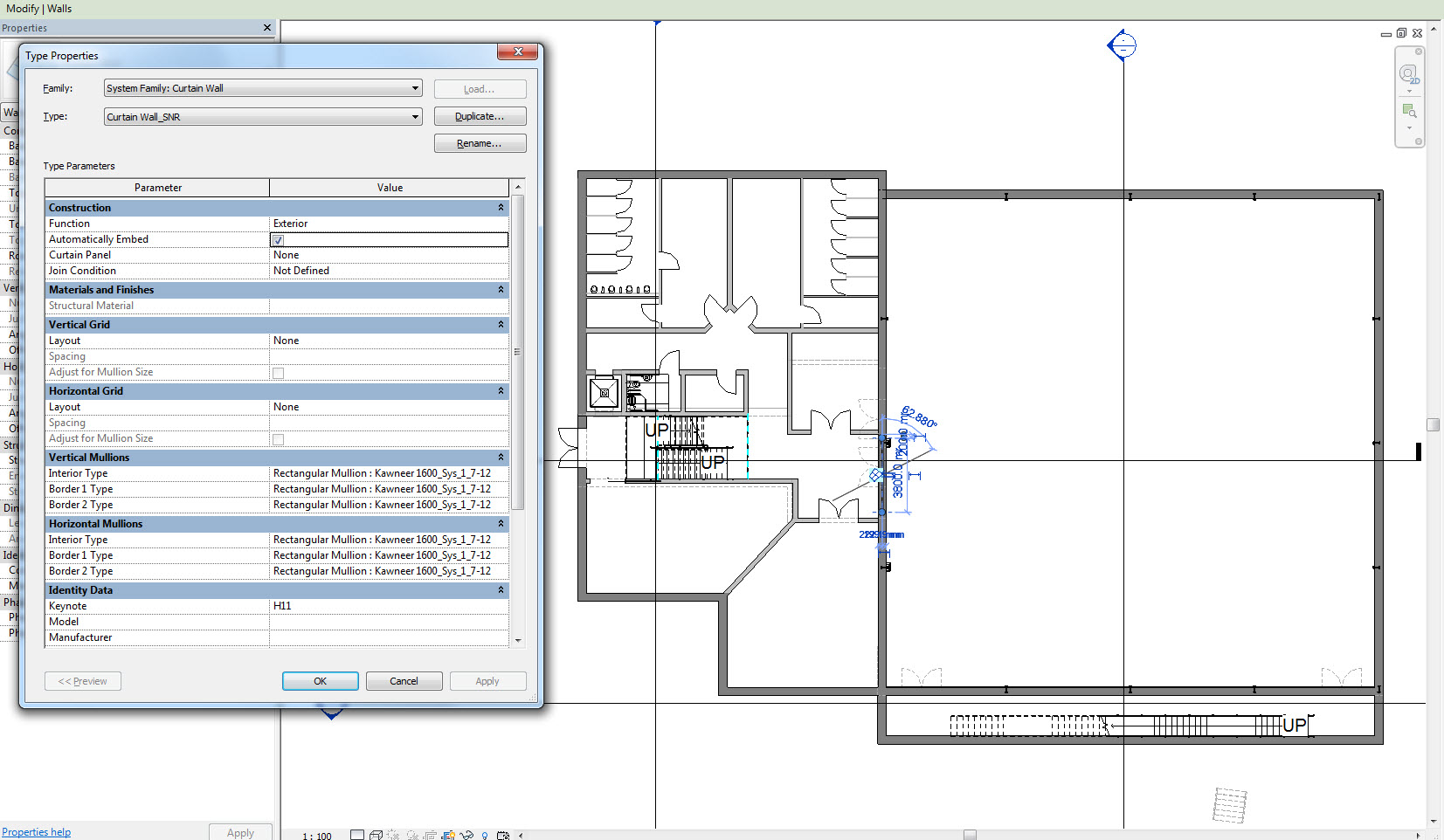

Image attached as requested! I really don't know what I am omitting here. I have done this so many times before but not with 2014. I can only pinpoint the lack of experience with 2014, but I know that this feature remains the same with earlier versions. In the attached image you can see the curtain wall within the separating wall dividing the large room on the right from the cluster of room on the left. The Type properties in opened and automatically embed in ticked and the Apply button is greyed out to indicate that the properties has been applied to the curtain wall. The curtain wall is highlighted too to indicate that it is selected.

Show me an image of the elevation and section.  What is the height of your wall and the height of your curtain wall base and top constraints?

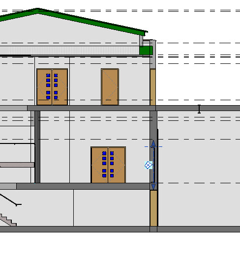

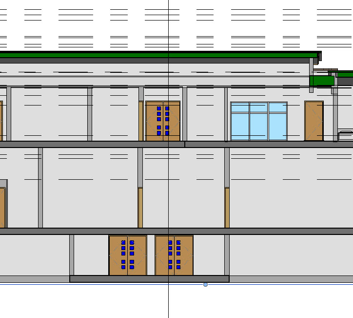

Section and elevation looking towards the large room. See previous plan.

Are you sure uou don't have two walls in the same place?  Hide the solid wall and see what happens.
Also, nothing special here, right?  No phases, design options and normal walls - no walls by face or in-place walls.

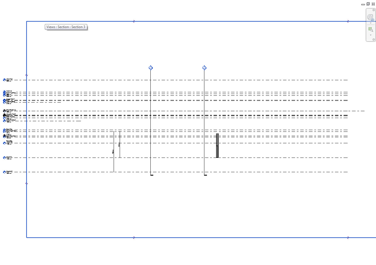

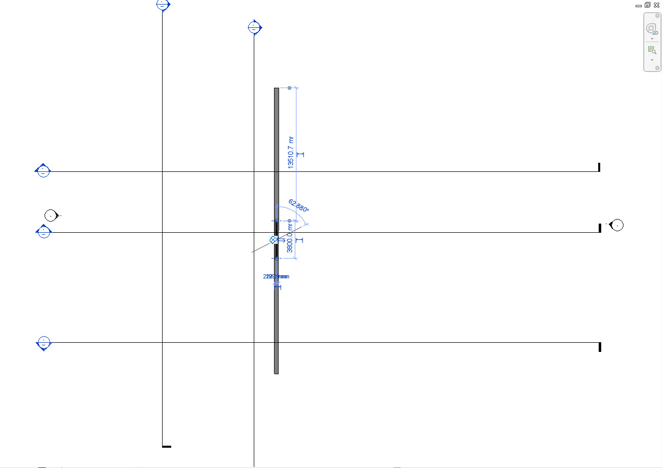

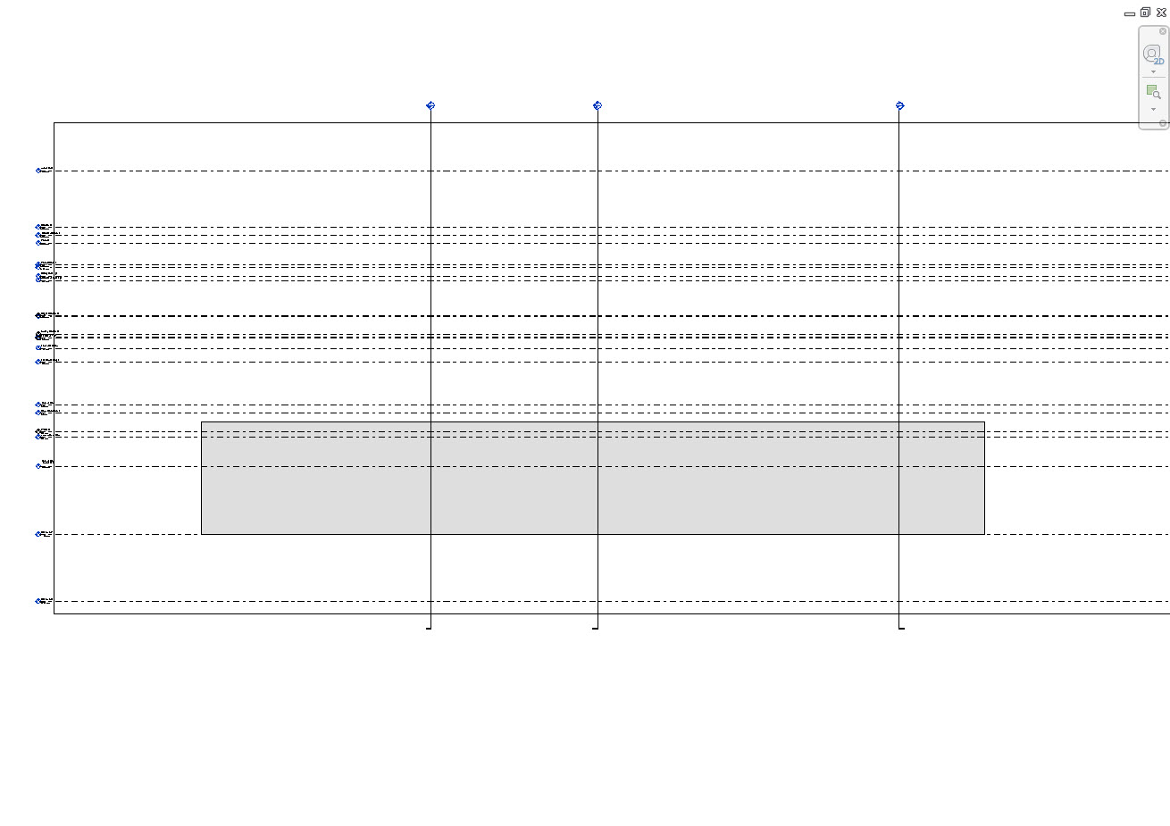

Request uploaded. Still the same problem. The only things not deleted are section,elevation and scope box graphics.
127635_PlanTroubleshooting.jpg127635_ElevationTroubleshooting.jpg127635_SectionTroubleshooting.jpg

@WWHub: Instead of posting the file, I posted images instead. I don't know why the file size is still nearly 5M, though I have now deleted everything includind the levels and elevations and sections, except the wall and curtain wall you want. How do I make this further smaller so I can post it here?

Delete all views, schedules and legends except for plan and elevation.  Also get rid of all those extra levels.  From a single simple view do a save as.
