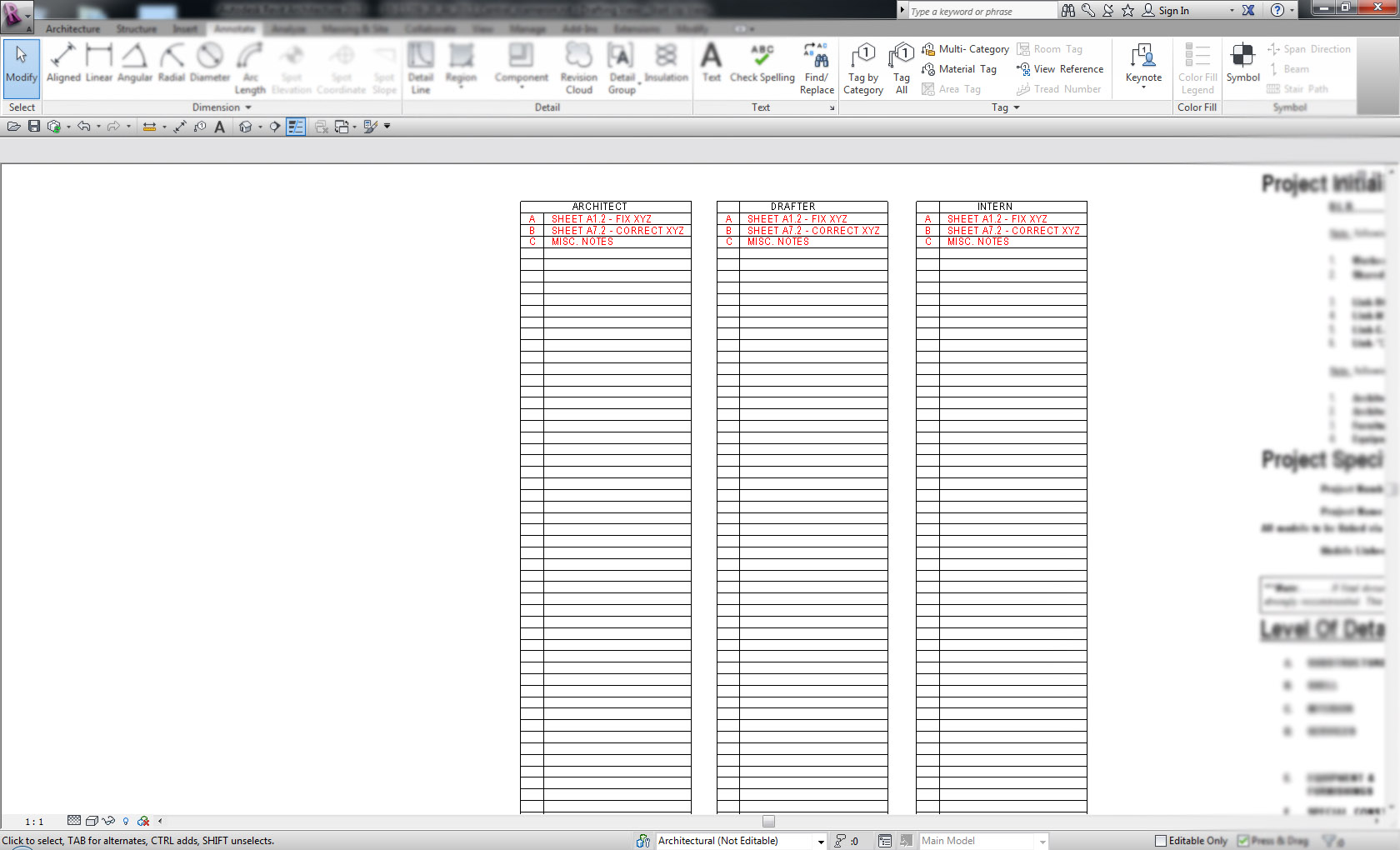

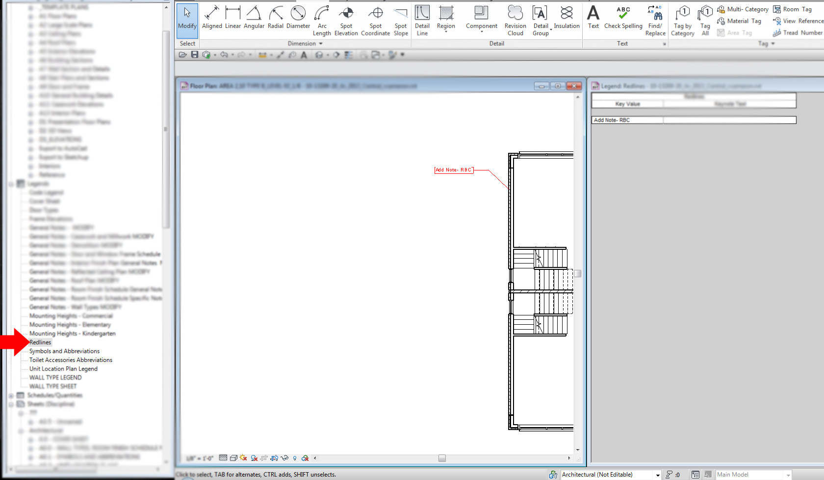

Revit, can...sort of do this already.  Create a text type or keynote text that is all red.  Set a parameter to read the red-liner's initials. Have that user complete the redlining process.  Whether its through keynoting (or other) you should be able to create a schedule that transmits the information to the end user for the changes that HAVE and WILL be taking place.
So you won't be able to use it on schedule sheets, or legends (just anything that is a wall, window, etc...), but you will be able to use it on pretty much everything else.
I'll take a screenshot.  Sorry for the blurring.  Winking
-rbc

WWHub is correct, there are better programs out there.  I was simply mentioning that you could track who made the changes by simply putting your initials after the note (also could include a date/timestamp).
However, you could also create a "start up page" in your Revit model that tracks these changes AND every time ANYONE opens the model it defaults to that "start up page" first, creating the ability to notify users of the tasks that
A) are completed
B) need to be completed
C) when they were issued and by who
D) gives them a list of things to do for the day
All locally within Revit...
This accomplishes another task... which is assignment of work to team members WITHOUT having to take another step to inform them.  also, everytime they open the file AND Person X can see what task Person Y is doing once they open the revit (collaboration) model.  Winking  Whoops, I left off the "Date stamp" on the schedule.  Cryingsee attached)
